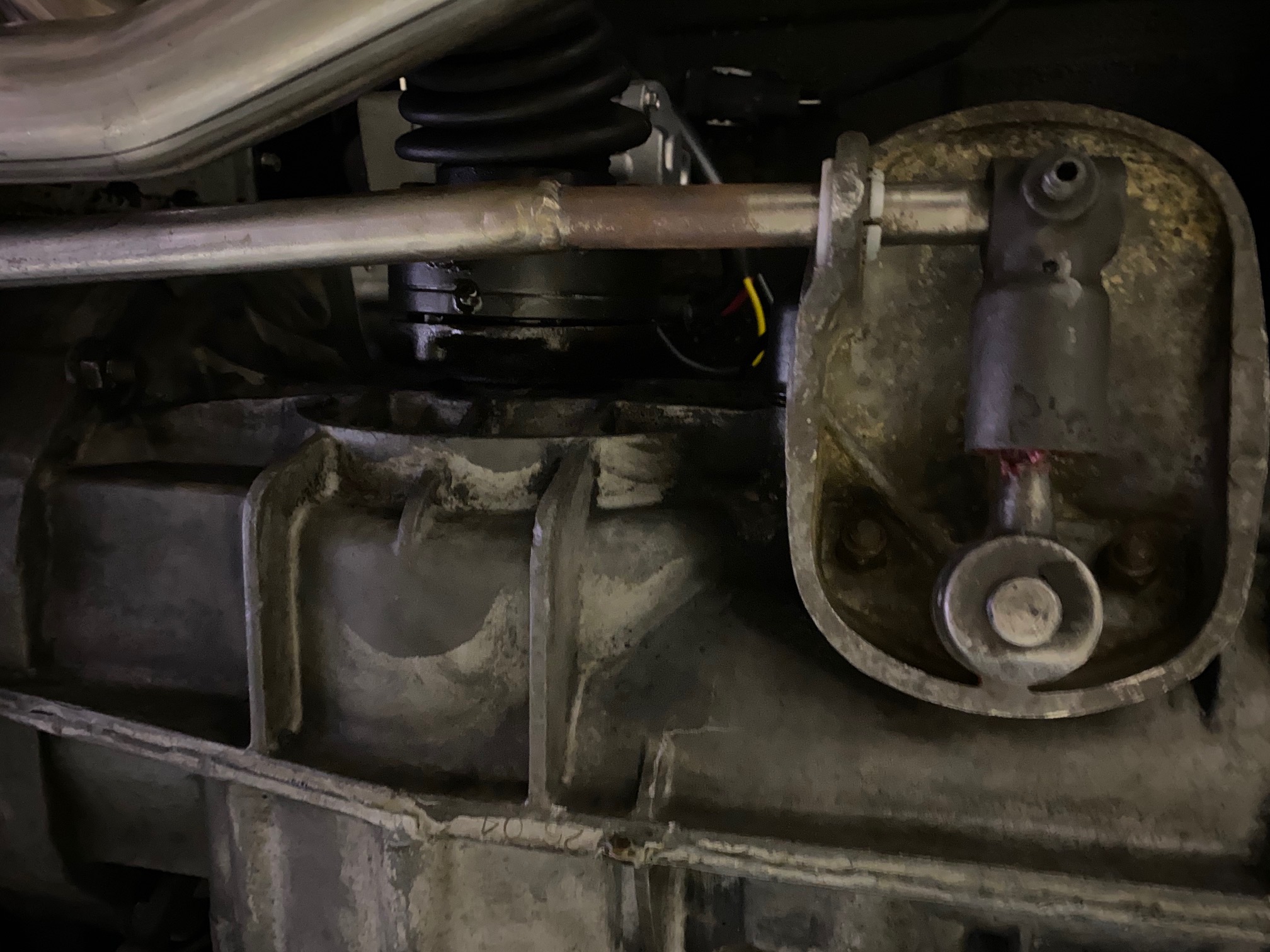

So... the engine is in (I’m using the NaroEscape -6 front mount) and, seeming because of the mount, it sits lower than stock. The Patrick Motorsport -6 shift linkage rod I intended on using, wont work. It interferes with the engine case and doesn’t seem to have a workaround. If the engine were 1/4” - 1/2” higher at the firewall, it looks like it would slip in, but alas, the engine is not going anywhere, lol.
I’m tempted to just bend the PMS bar end upward (maybe a couple inches from where it goes from the narrow shank to the bar rod) to give it the clearance but that would change the angle it goes into the rear bushing and connects to the shift lever... so I figured I’d ask if anyone else had an issue with the bar hitting the engine case and any options I might have. I’m OK with modding the old -4 rod too. Might be worth a shot but figured I’d ask here first.
The other threads I found look like the stock rod modded is the move.
Thanks

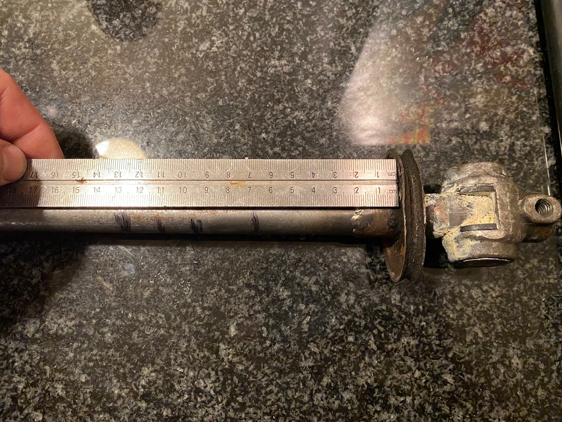

Rich and Nick the only issue with using that linkage I moded is it was not modded for a naro mount
RichPugh
post Sep 25 2020, 06:39 PM
Posts: 132
Joined: 28-October 14
From: Baltimore, MD
Member No.: 18,068
QUOTE(mb911 @ Sep 25 2020, 06:28 AM) *
I test fit it to see how far off it was and made a few marks to denote the extreme limits of the shift rod position when shifting forward/rearward.
The 2 center-most marks on the bar denotes the area where the case touches the bar in neutral (if the bar were connected). The forward most and rear most marks denote the furthest place the case would contact the bar when shifting forward and backward.
Looks like your bar would be perfect if it were notched at about 60mm from the rubber boot lip, to drop down, go straight back until about 135mm then go back up and continue straight back.
Ignore the dripping CV axle flanges... LOL. I havent cleaned them, re-greased them and replaces the gaskets yet.
