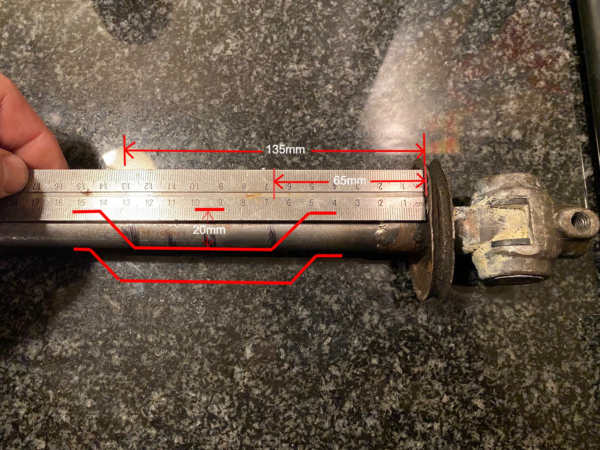

I test fit it to see how far off it was and made a few marks to denote the extreme limits of the shift rod position when shifting forward/rearward.
The 2 center-most marks on the bar denotes the area where the case touches the bar in neutral (if the bar were connected). The forward most and rear most marks denote the furthest place the case would contact the bar when shifting forward and backward.
Looks like your bar would be perfect if it were notched at about 60mm from the rubber boot lip, to drop down, go straight back until about 135mm then go back up and continue straight back.
Ignore the dripping CV axle flanges... LOL. I havent cleaned them, re-greased them and replaces the gaskets yet.

So... Something like this would work. Ignore the rudimentary drawing and orientation of the bar. Pretend its correctly oriented horizontally and this would drop down...
