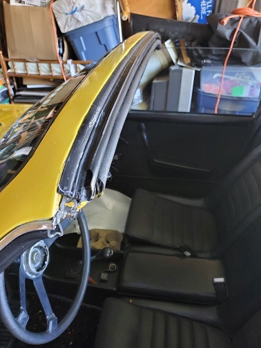

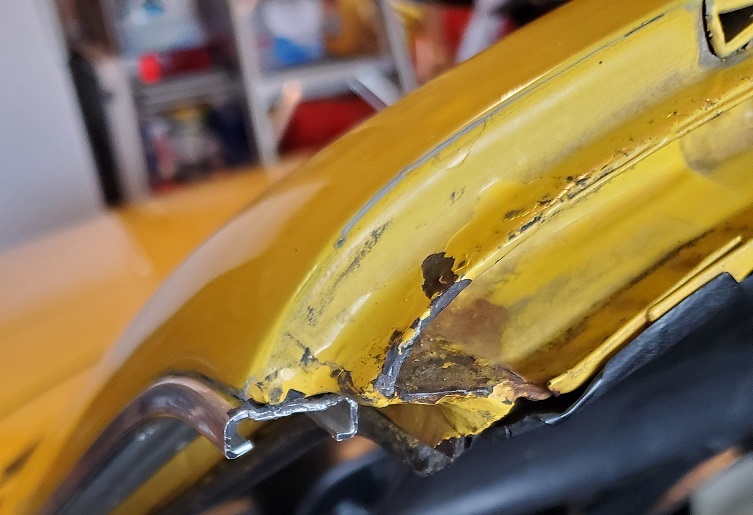

Replacing mine after ignoring for 10 years. I never drove it when it rained, only on nice days. Anyways, you can see the tab is gone (both sides). What impact will that have when installing the new seal? Also, I do not have the screw. What size should I get to replace?
I'm guessing it is easier to replace the main targa seal first then the lower seal, yes?
Thanks!

IronHillRestorations   The original part has a slot in the top corners fo...   Sep 28 2020, 01:31 PM
Mikey914   Even f you are missing the tab, you can make adjus...   Sep 28 2020, 02:10 PM
