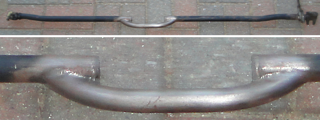

This is what they did to the 914-6 race cars
back in the day to clear a tab on the early aluminum
911 cases..

QUOTE(gandalf_025 @ Sep 28 2020, 06:05 PM) *
911 cases..
This "notch", placed close to the shift rod knuckle, would def clear the case. It wouldnt help with the other issue being the forward position of the engine and trans, but would def clear the case.
