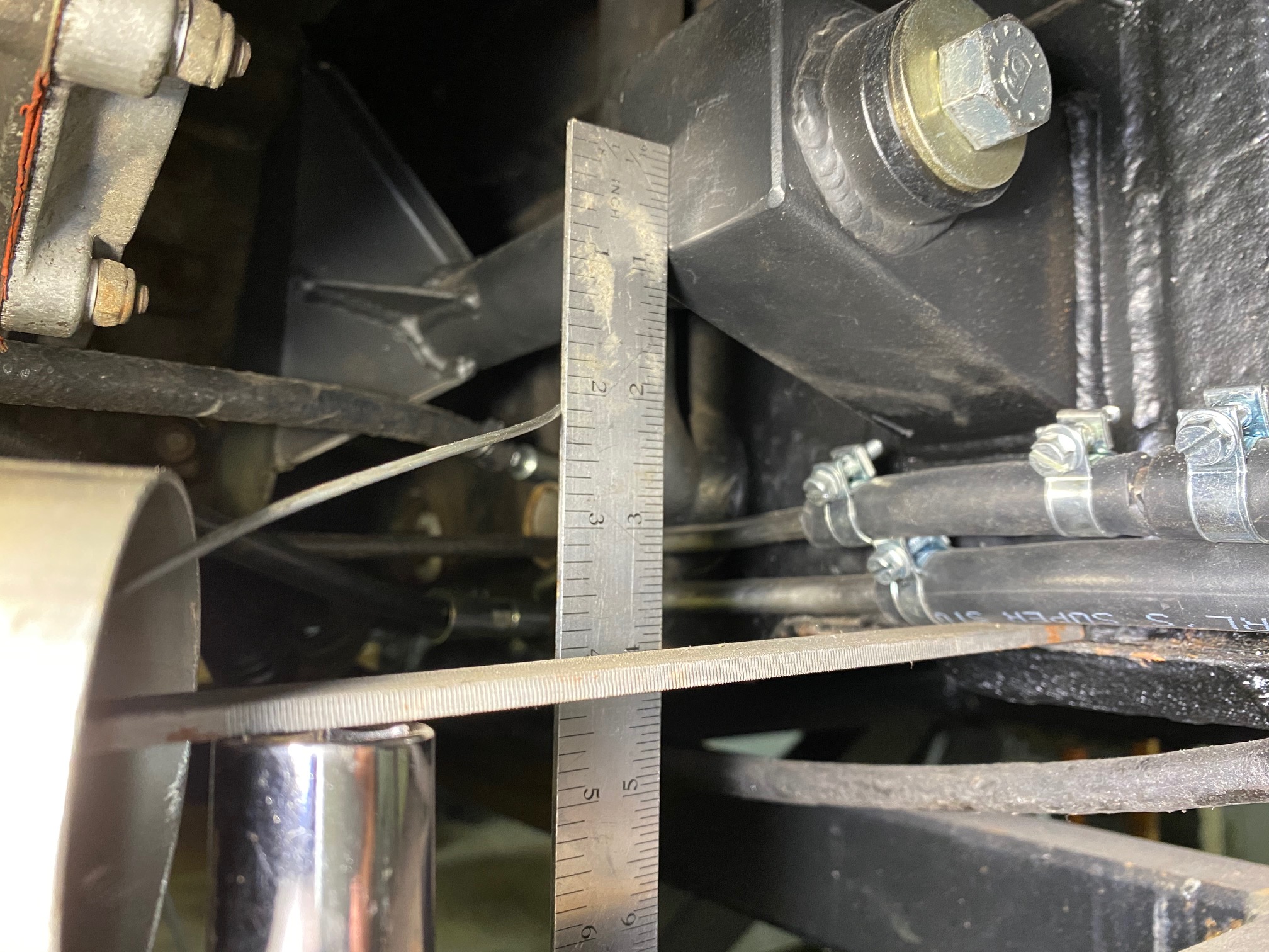

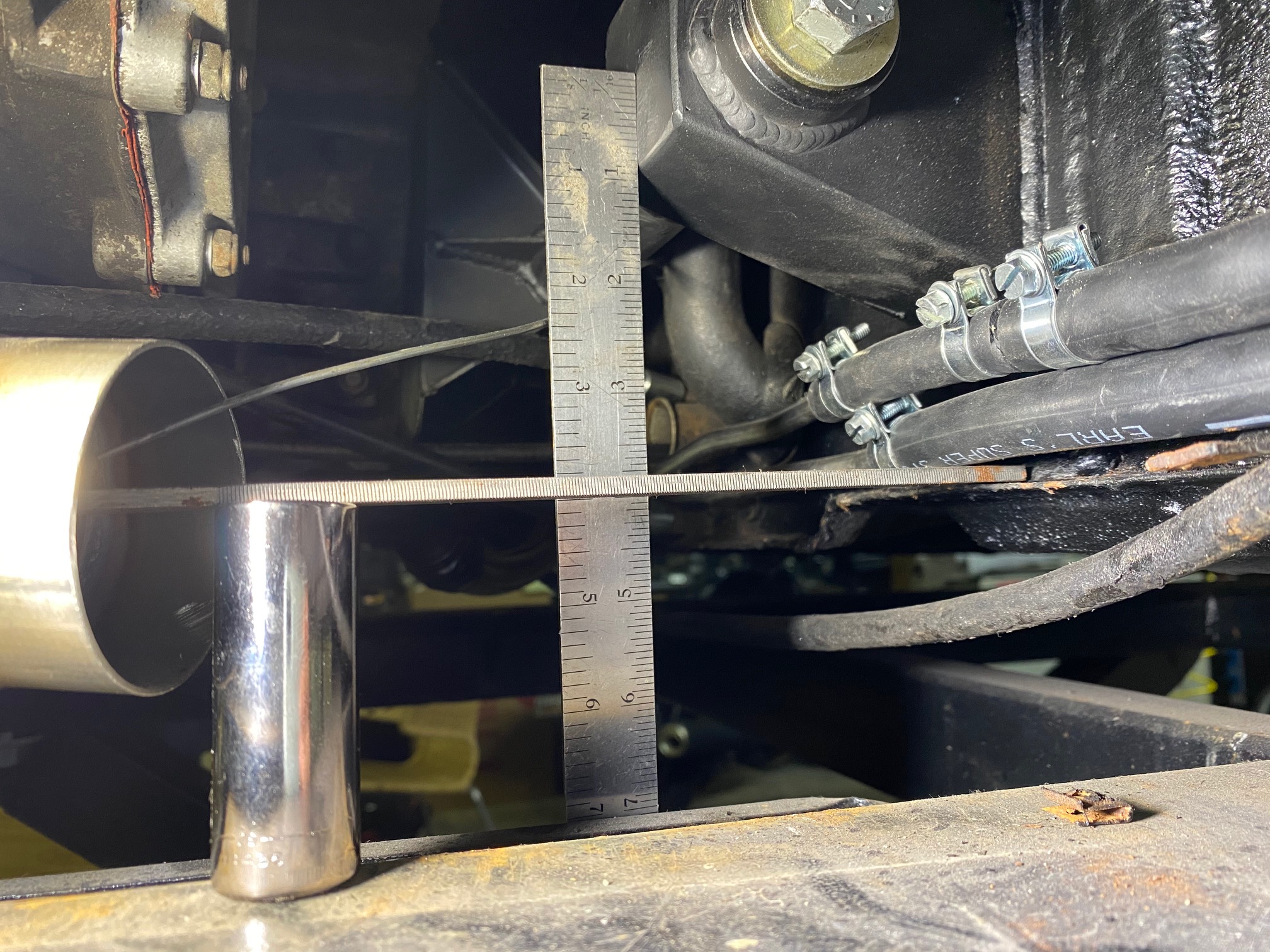

RichPugh
post Sep 29 2020, 12:24 PM
Posts: 132
Joined: 28-October 14
From: Baltimore, MD
Member No.: 18,068
Here's just a couple pics showing exactly where the mount ears were welded into place as well as thee Naro instructions. they are exactly where Naro tells you to put them. They're exactly 4" from the bottom ridge of the firewall to the center of the cross bar. please excuse my rudimentary bottom level line made up of a file and a socket, lol.
