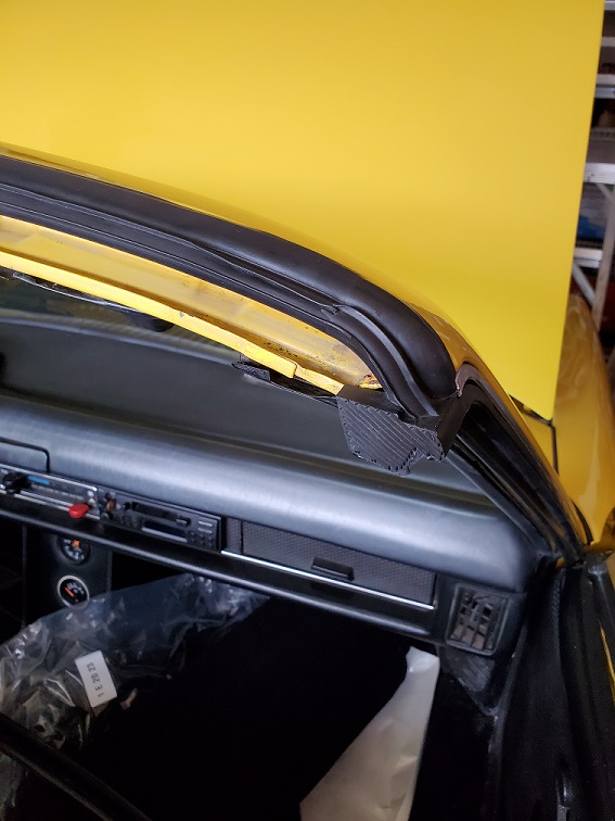

chandler1969   Replacing mine after ignoring for 10 years. I neve...   Sep 28 2020, 12:49 PM
IronHillRestorations   The original part has a slot in the top corners fo...   Sep 28 2020, 01:31 PM
Mikey914   Even f you are missing the tab, you can make adjus...   Sep 28 2020, 02:10 PM
chandler1969   Even f you are missing the tab, you can make adju...   Sep 28 2020, 02:48 PM

Costa05   Even f you are missing the tab, you can make adju...   Oct 7 2021, 08:15 PM
chandler1969   Got the top seal in. I think it turned out nice. S...   Sep 29 2020, 02:07 PM
Mikey914   I’ll source those this week and drop you some if...   Sep 29 2020, 10:06 PM
