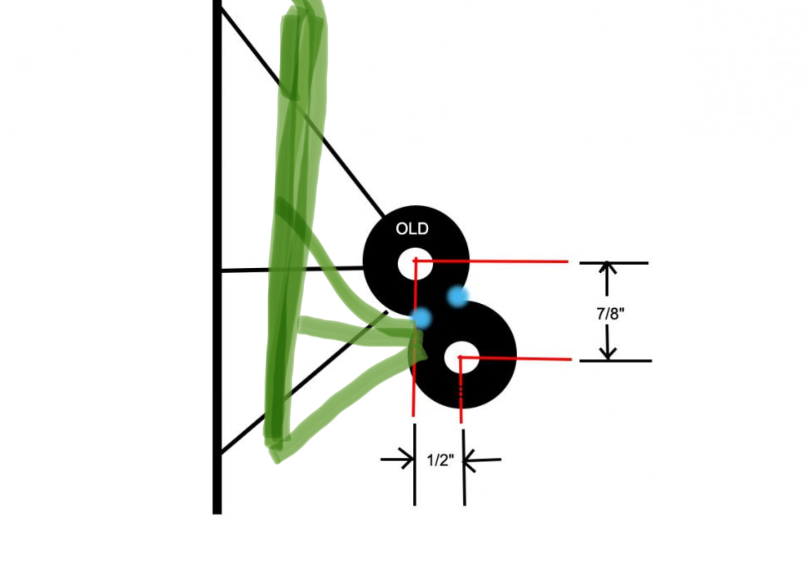

Why couldn’t we “just” do this?
Add thickness to the mount and relocate the u-shaped piece that boots to the engine up and back? Excuse pre-second cup of coffee drawing but you get the idea.

Tdskip   Why couldn’t we “just” do this? Add thickne...   Sep 30 2020, 06:17 AM
