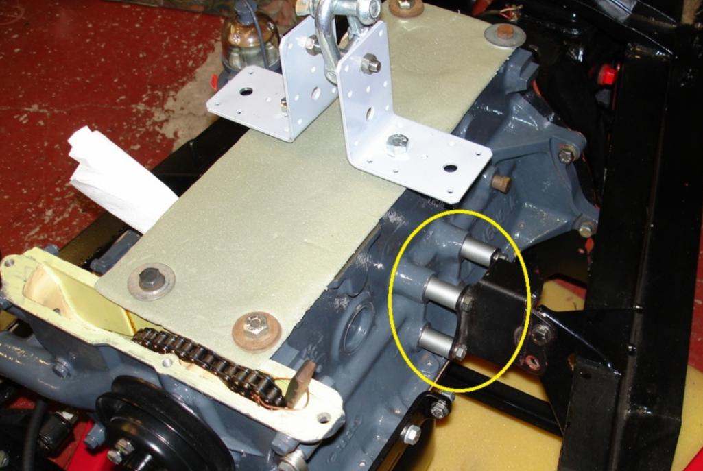

So... the engine is in (I’m using the NaroEscape -6 front mount) and, seeming because of the mount, it sits lower than stock. The Patrick Motorsport -6 shift linkage rod I intended on using, wont work. It interferes with the engine case and doesn’t seem to have a workaround. If the engine were 1/4” - 1/2” higher at the firewall, it looks like it would slip in, but alas, the engine is not going anywhere, lol.
I’m tempted to just bend the PMS bar end upward (maybe a couple inches from where it goes from the narrow shank to the bar rod) to give it the clearance but that would change the angle it goes into the rear bushing and connects to the shift lever... so I figured I’d ask if anyone else had an issue with the bar hitting the engine case and any options I might have. I’m OK with modding the old -4 rod too. Might be worth a shot but figured I’d ask here first.
The other threads I found look like the stock rod modded is the move.
Thanks
RichAttached Image

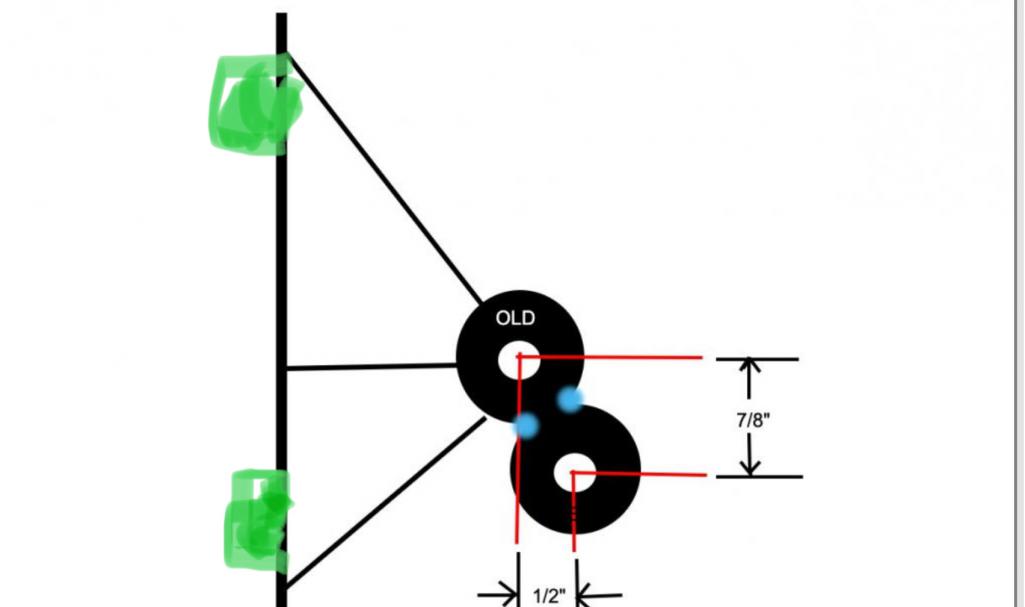

One other way to go it is to add spacers on the mount (provided they are very strong), like the green shown here on the u-shaped piece.
This is how Lotus did it on the Elan which, granted, only has a 1.6L engine.

QUOTE(Tdskip @ Sep 30 2020, 08:21 AM) *
This is what I mentioned above too... just using spacers for the fore/aft adjustment and figuring our another way to "lift" the engine up. Maybe Bob @ Naro will help. We have (at least) 2 identical situations... 'Live Free & Drive' is having identical issues. Maybe Naro made a bad batch?

QUOTE(RichPugh @ Sep 30 2020, 10:54 AM) *
So, in theory, if you welded the existing mount 3/4 higher than instructions and then added 1/2 spacer we should be OK?
RichPugh
post Sep 30 2020, 11:09 AM
Posts: 132
Joined: 28-October 14
From: Baltimore, MD
Member No.: 18,068
Welding the ears in 3/4" higher would/could result in interference complication with the rear brake bias unit (that can currently just move upward slightly and remain connected as is). I was going to leave my 'ears' in place on the firewall and re-engineer the cradle portion of the mount... the U-shaped plate that mounts to the engine case, if it was cut off and either re-welded in a 3/4" higher position, or re-cut and drilled higher and welded in new... Not sure. It's a lot to deal with. I didnt want to pull the engine back out so... I guess I'm going to have to at this point.
