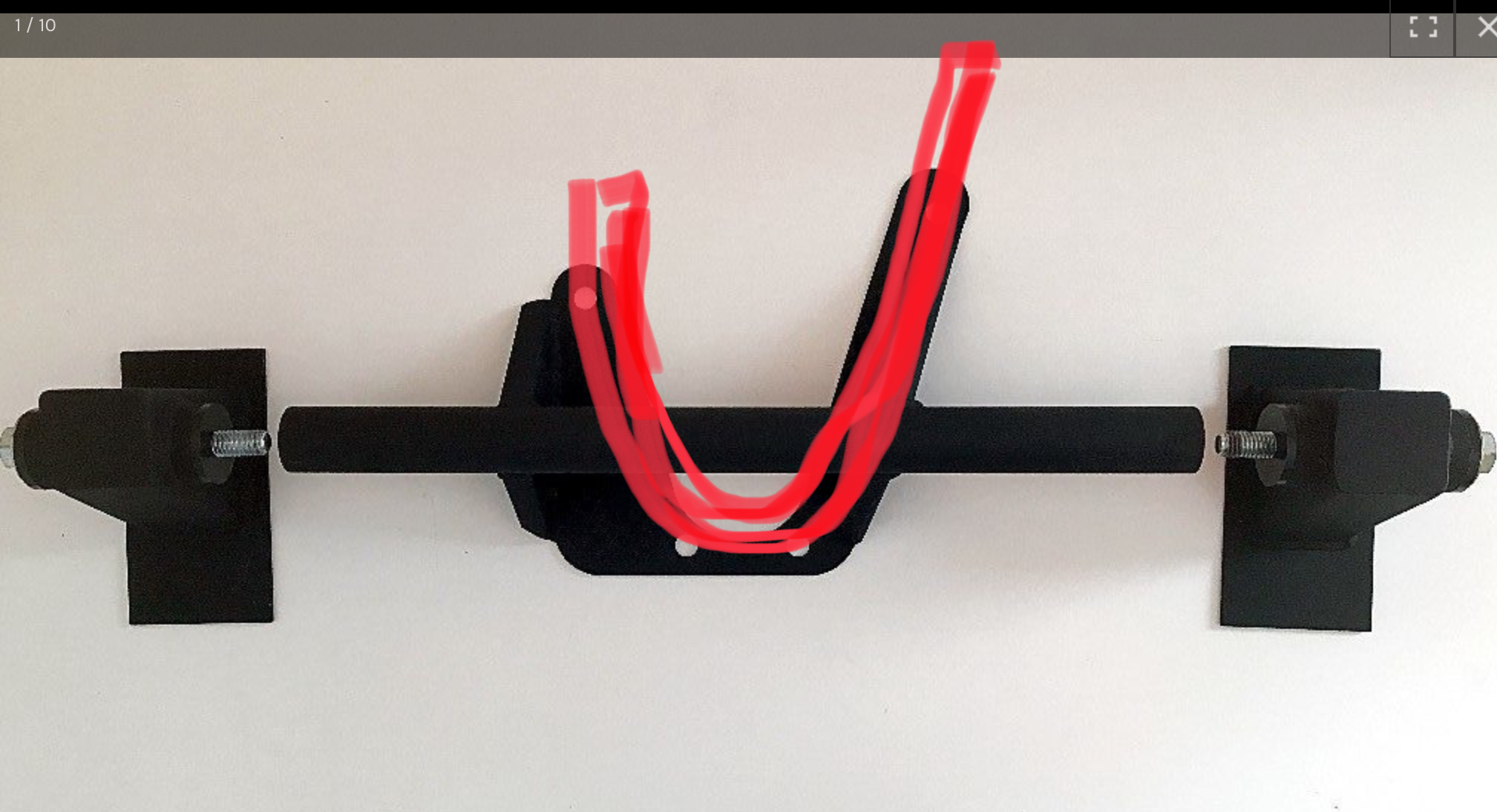

Tdskip
post Oct 1 2020, 12:31 PM
Posts: 3,784
Joined: 1-December 17
From: soCal
Member No.: 21,666
Like this - with the red being thicker steel to help located it back toward the rear of the car?

Tdskip   Why couldn’t we “just” do this? Add thickne...   Sep 30 2020, 06:17 AM
Tdskip   One other way to go it is to add spacers on the mo...   Sep 30 2020, 06:21 AM
RichPugh   One other way to go it is to add spacers on the m...   Sep 30 2020, 09:54 AM
Tdskip   One other way to go it is to add spacers on the ...   Sep 30 2020, 10:24 AM

Tdskip   Like this - with the red being thicker steel to he...   Oct 1 2020, 12:31 PM
mb911   Like this - with the red being thicker steel to h...   Oct 1 2020, 06:19 PM
