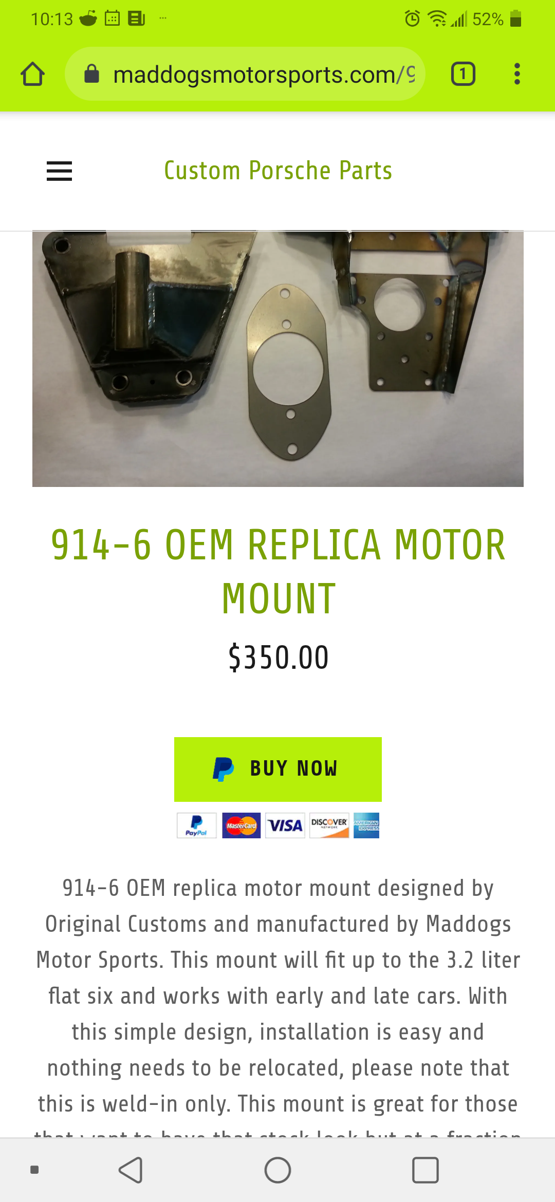

For those not yet having installed one I would suggest this unit.. No I don't get a kickback or have anything to do with the company but this is the simplest and allows the most clearance of any mount on the market. Attached Image
