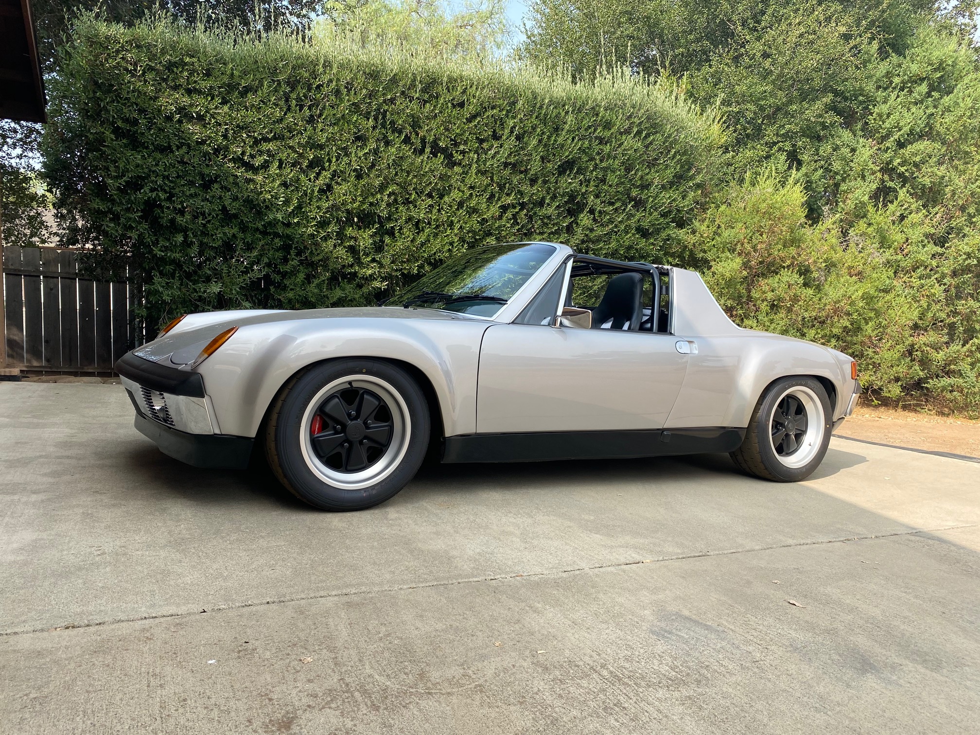

Mine is a 3.8, "all out" open checkbook build--I was in the right place at the right time and as a life long 914 guy it was the 10/10ths car I never thought I'd personally own. I didn't really even consider the drivability so after 8 months of ownership and about 1500mi I can answer that to some degree.
Like Clay, I'm a HP junkie but also a 914 junkie, two worlds collide and it's magic (IMG:style_emoticons/default/happy11.gif)
For actual road use, I'm not going to lie, it's actually pretty f*ching amazing-- 911 TT fast and 914 characteristics. The front end is seems a litte stiff to me, but outside of that I really can't complain about ride quality--keep in mind my chassis has all the stiffening available, as well as the trailing arms and extensive tubing and suspension bracing. The drive train is incredibly well sorted (now that its been "rescued" and is being driven). Starts on 1st crank, trans feels fluidly smooth (915 wevo). Inside the engine bay looks like it was all factory thanks to well sorted wiring/tins etc.
So on the package level, its really put together well, to the point where it could be a daily driver.
On the "touring use" side of things...well...I'm getting there, having grown up with 914's it never really occurred to me that it wasn't a good idea to jump in and make super long trips, it was my car and that's what it was for (IMG:style_emoticons/default/confused24.gif)
My only beef with driving my "WMD" to something like WCR (500 mi one way for me) is the noise--on my car there's no sound deadening on the FW in the bay or in the cabin so the noise, while not outright annoying, isn't really conducive to long distance touring per say...when I'm not in the throttle, the exhaust tone isn't bad really, but still louder than is comfortable for long trips. I plan on addressing that and I my goal is to make it the most civilized version of it that it could be. Ironically it has an audiophile stereo installation that I don't really turn on.
Gratuitous photo op (IMG:style_emoticons/default/wub.gif)
