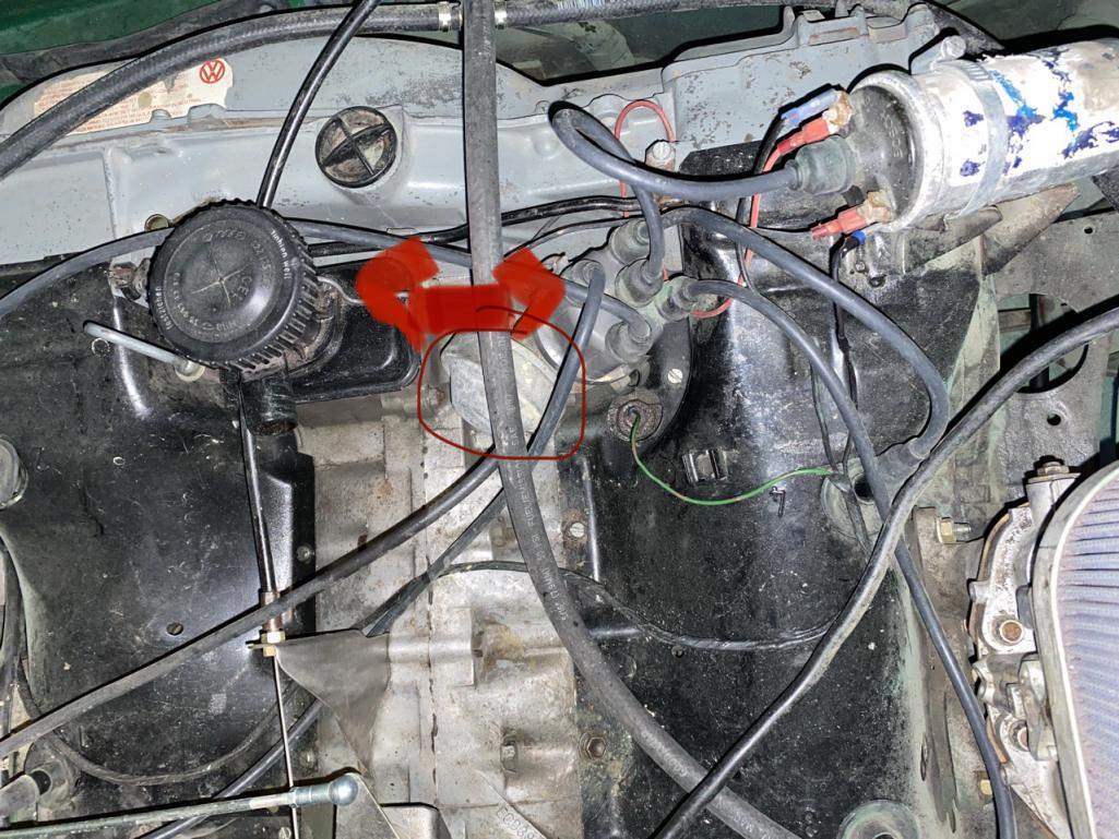

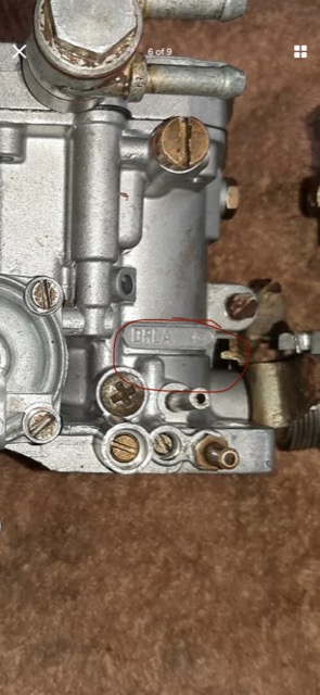

That helps. Judging by that intake to carb gasket, those carbs have been on a long time. As mentioned, lots of possibilities. Not relevant, but where does that black wire on the + terminal go to? The line coming off the distr vacuum canister too.

The black wire from the +ve terminal goes to the starter motor
The rest of the set up looks like this

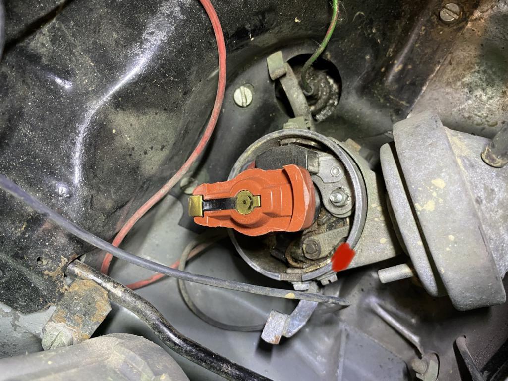

Hello,
1. Did you remove or rotate your dizzy? I know that car was running well and it is running when the car arrived to you.
2. If you still have the original or stock 1975 1.8 Dizzy, the TDC notch on your dizzy should be the RED dot on the pic that I edited.
3. Stock TDC (#1) usually around 11 o’clock and should be on the notch (see pic)
4. If you didn’t touch anything on your engine during the body repair, probably the reason of your rough idle is a carb issue. Maybe jets are clogged or dirty.
I also included a pic from other post that show the vacuum canister is facing/aligned to the Oil tower fill. My previous 75 1.8 F.I. and a 74 1.8 F.I. of a friend that I help fixed has the same location.
Below is a pic where you can find the size of your carb for dellerto.
