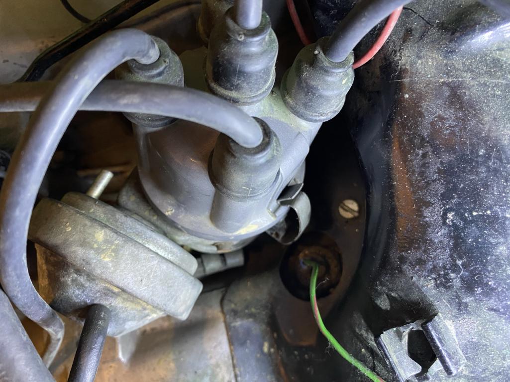

I haven't disturbed anything since the car arrived, I couldn't drive it in the UK so I didn't know how it was running but it started (after a few turns) and idled OK so I didn't mess with anything
I have only taken the dizzy cap off to look inside to check the contact points and the condition of the rotor arm
There are lugs for the spring clips so I am presuming I have the cap on correctly, it could be possible to rotate it by 180 degrees - would this make a difference?
I think the firing order / leads are correct, if you look at the lead from cylinder one and go clockwise, it is followed by 4, then 3 then 2 so 2 is next to 1. Its only incorrect if you go anti clockwise (as then its 1,2,3,4)Attached Image

Gint   Your firing order is correct based on the picture ...   Oct 7 2020, 06:32 AM
dt4   Your firing order is correct based on the picture...   Oct 7 2020, 06:54 AM
Gint   I corrected by statement about #1 position in my l...   Oct 7 2020, 07:11 AM
