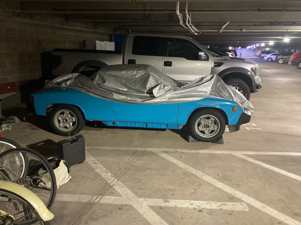

Greeting from Denver. I was at a 996 meetup a few weeks ago and started talking to a guy selling his 914 project car. A week later, I am said owner of a 1975 Laguna Blue 914 with two 2.0L motors, a couple of transmissions, and lots of parts to put it together. To top it all off, I made a new friend in the PO and have had a warm welcome into the 914 world.
PO spent a lot of money and effort to addressing rust so I'm starting off with a fantastic chassis. I'm spoiled as I come from the 996 world where I don't have to worry about many of the issues that come with 45+ year old cars. I'm decent with a wrench, though I have no fabricating skills and have never rebuilt a motor, so this is all a learning experience.
The plan is to clean the "complete" motor and redo seals, belts, gaskets, other basic things to get it running and just drive it. Meanwhile I'll explore options on the second block, and am already looking into a 2056 build. Step one of getting the car back on the road looks relatively straightforward, but the catch is I don't have a garage/shop to work on the car, so much of it will be done in my livingroom and parking spot.

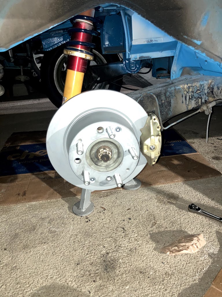

Rotors, pads, and calipers installed. There is binding between pads and rotors, so will need to adjust the calipers...which I hear is not fun. Calipers won't sit flush to the trailing arm, so need to also figure out how to torque them down.
