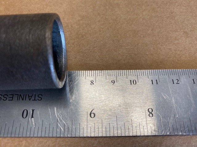

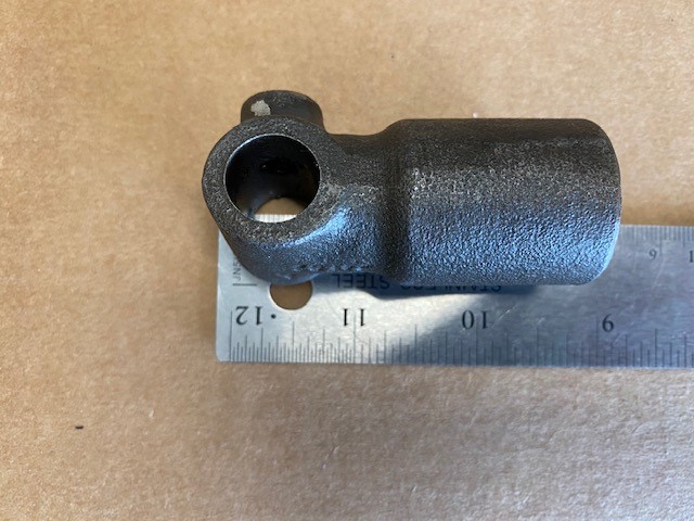

I measured mine and both are 65 mm. Anyone know where to get a longer one?

QUOTE(BPic @ Oct 17 2020, 01:13 PM) *
ALL the side shift, 73-76 914-4 transmissions have the same parts. There are NOT two different lengths.

dr914@autoatlanta.com   that shift head looks correct, have you installed ...   Oct 17 2020, 02:43 PM
BPic   that shift head looks correct, have you installed...   Oct 17 2020, 02:48 PM
mepstein   Early ones for the tailshifter are shorter than th...   Oct 17 2020, 02:28 PM
Rich Bontempi   Early ones for the tailshifter are shorter than t...   Oct 17 2020, 02:43 PM
