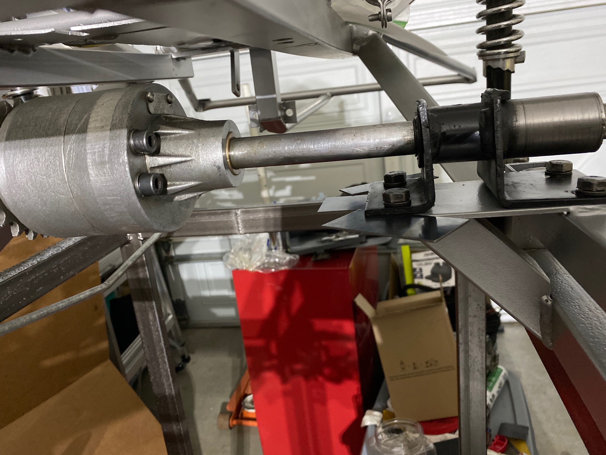

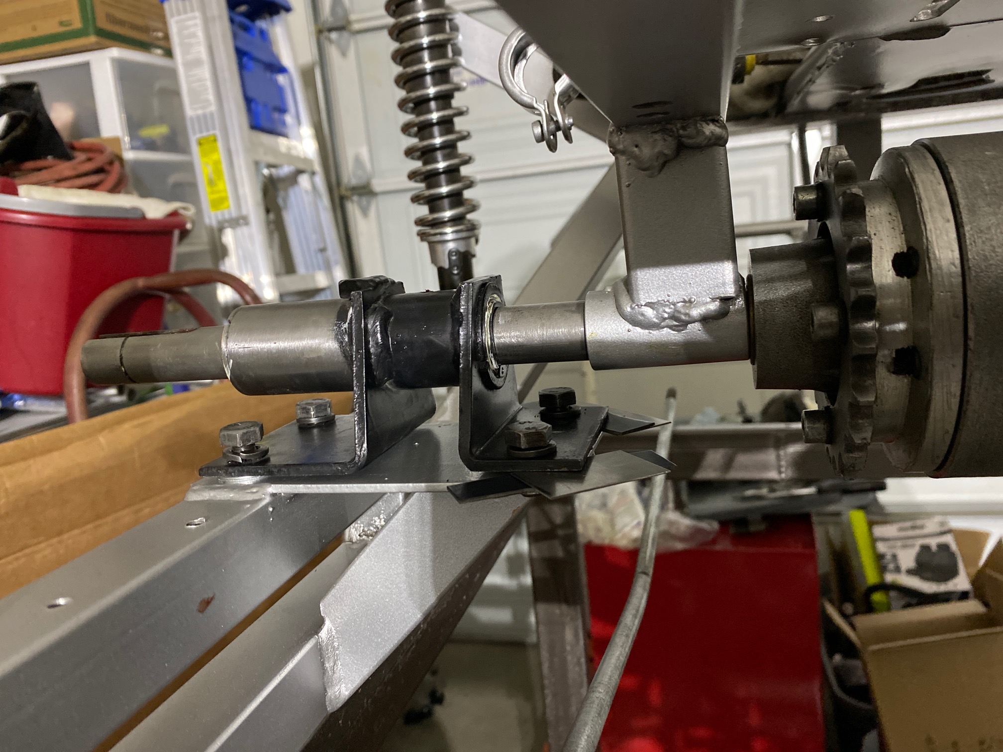

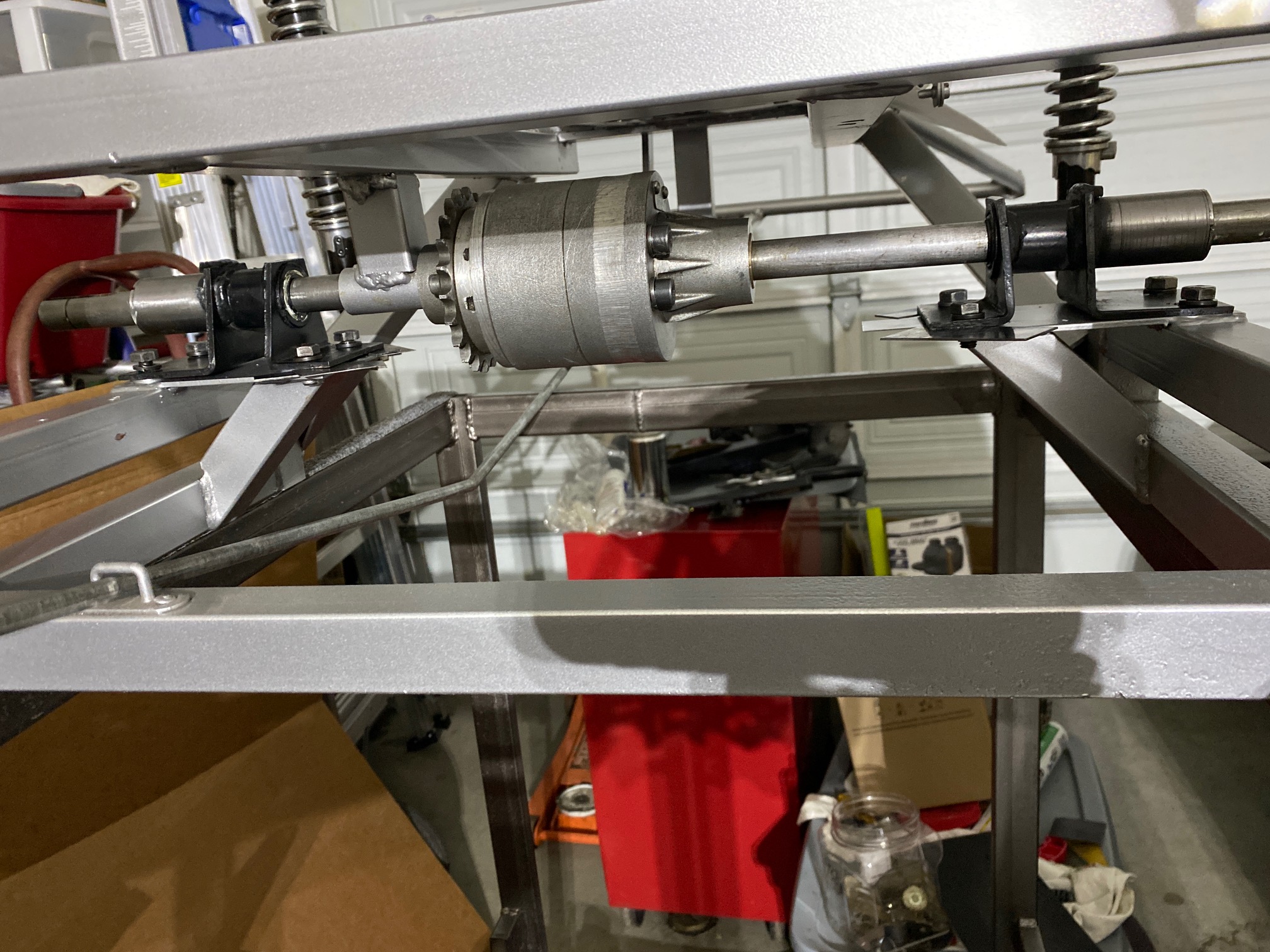

Frustrating time trying to align the rear axle and the bearing blocks. A center support next to the diff (see pics) causes interference if the bearing blocks are are not level to it. I suspect that the chassis mounting pads are also not flat, or level with each other.
My have to bring it back to work and put it on my big surface plate and measure everything for shims. Ughhhhhhhhh.
