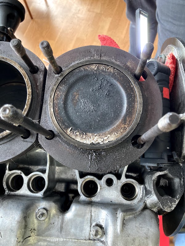

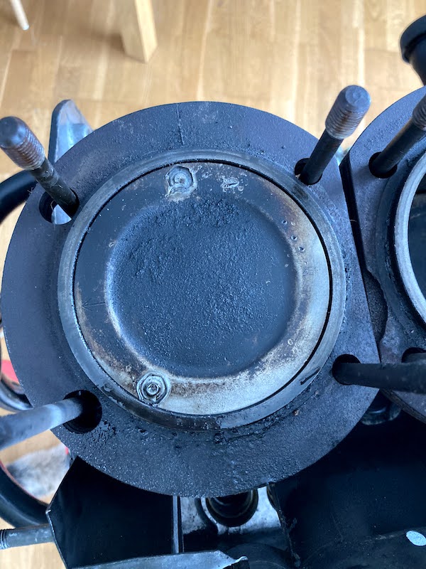

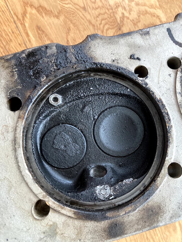

Got around to working on the replacement motor today. Turned it, and it spun 359 degrees, then stuck. Tried it again...same result. Pulled the motor apart and found this mess. It appears that a PO dropped a nut into the motor and at some point it went BOOM. But I was told the motor was good when it last ran...
At this point, I'm 0/2 on motors that came with this car. There is a 3rd motor, but I'm not willing to chance anything even though that motor turns over. Complete teardown and rebuild coming and I'll go to a shop for machine work. The question is do I go 2056 at this point? Will start calling shops in the Denver area starting tomorrow, and explore what my other options are.
