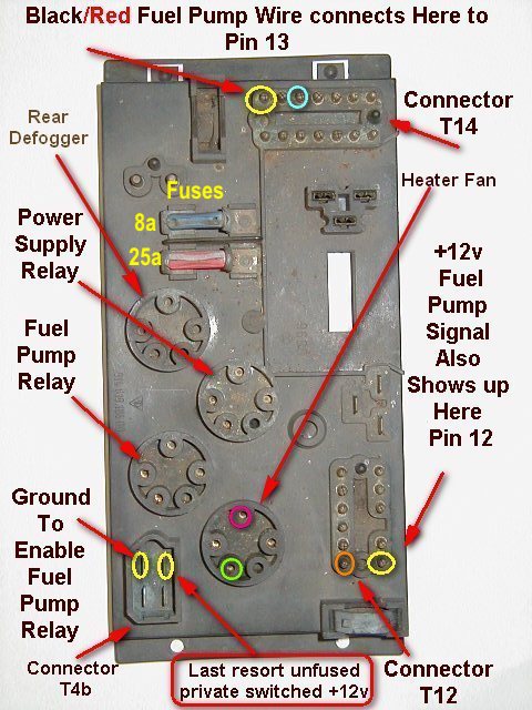

JP, there's also a couple of fuses next to each other on the relay board in the engine bay.
The 25 amp fuse (in the socket towards the rear of the car) is the main power fuse for the board - it protects the fuel pump and the heater blower fan.
The 8 amp fuse is only for a rear window defogger (if vehicle is so equipped).
If not already posted in this thread, go over Jeff Bowlsby's checklist: https://bowlsby.net/914/Classic/zTN_FI_FPChecklist2.pdf
