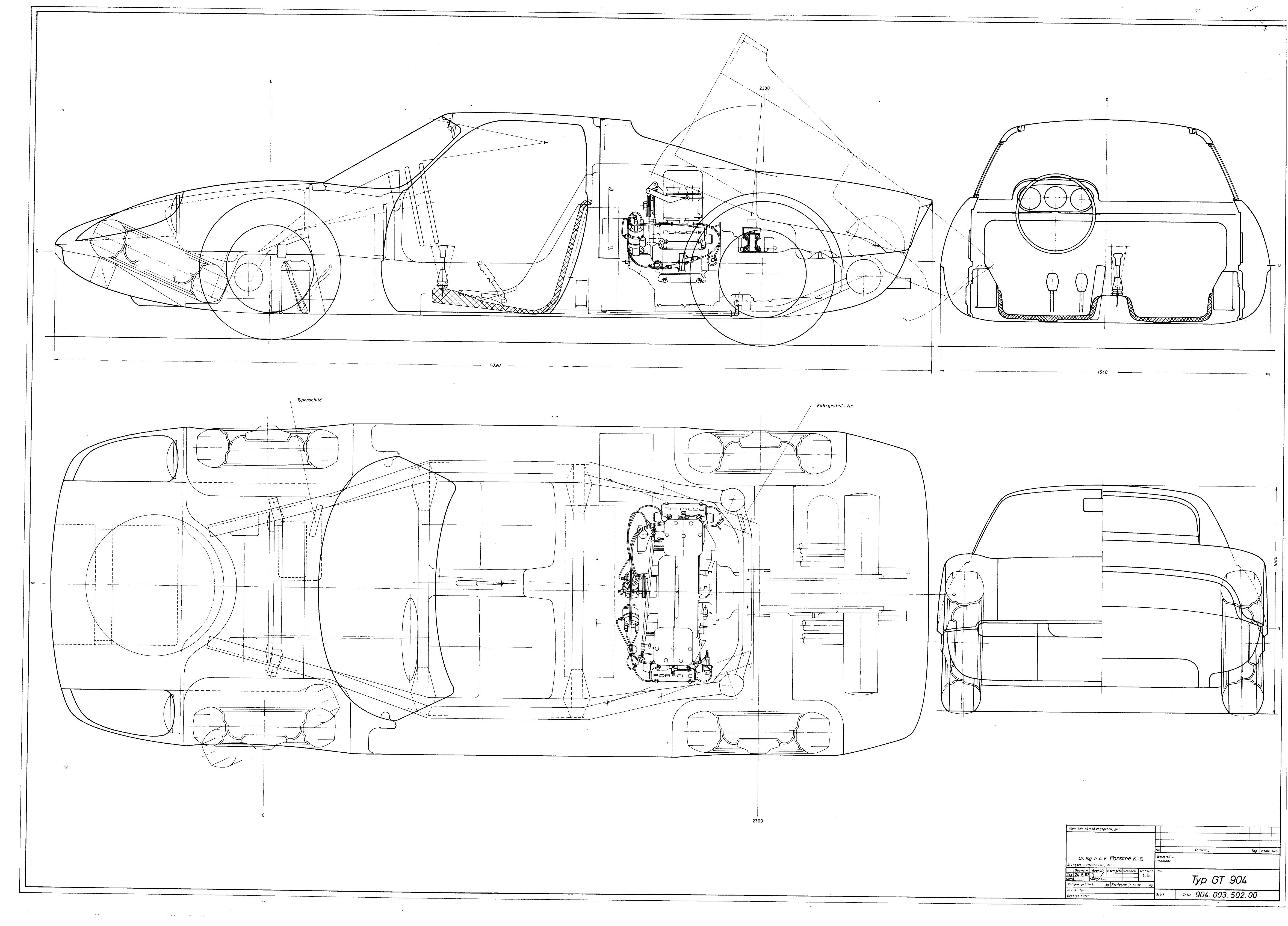

How far back from the original one is the new straight up shift level? I am looking into doing this with the stock setup. Probably upgrading to a Rennshift but with a straight up stick.
From the 904 side drawing, the shifter is before the steering center point (drawing a vertical line down).
The 914/4 or /6 in the center image, is way to the front, as we know. With the bent lever, the movement is much more of an up and down vs. front to back.
Last cross section is the 914-8 where the straight up shifter is pretty much in line (vertical) with the steering center point. The 914-8 had a completely different shifter linkage that actually went 90 degrees to the passenger side in front of the seat, then along the passenger long.
