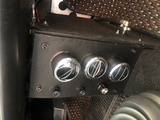

Steve   Three years ago, I bought the same under dash evap...   Nov 2 2020, 09:17 AM

Steve   New Mini cooler with built in vents!! Sam...   Dec 21 2020, 01:21 PM
