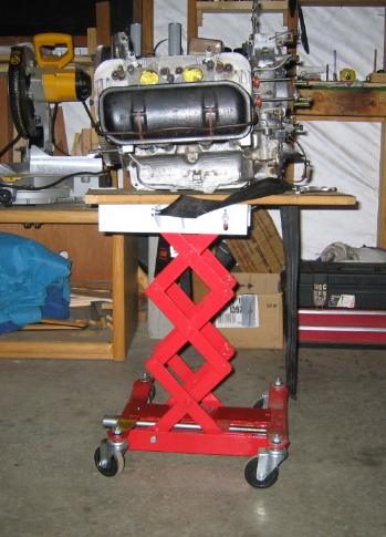

Not really practical for splitting the case and doing engine internals but has worked great for everything that I have done. Had the P&Cs off. Can be raised and lowered, rolls around. I can use it to take the engine out and put it in as well. I think it is actually a transmission stand.
