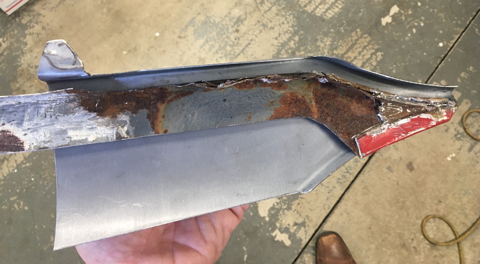

I am trying to understand the construction of the rear part of the fender, more precisely the area joining the front cowling.
Below is a sketch of how I think it is made but i would like someone to confirm...
Having removed the seam sealer in the upper rear area, I have discovered "this" (IMG:style_emoticons/default/dry.gif) which is not really unusual, but clearly a pain to fix. I am not sure though what I am looking at. If my sketch is correct, I guess the inner rusted layer is from the fender rear bulkhead that actually becomes an inner layer on the rear upper point of the fender by the door and cowling junction.
I might be able to cut this from the underside preventing me from cutting the outer surface of the fender. But I would like to better understand what is happening at the junction to the body.
How many layers are there from the fender, one or two?
Is the metal peeling off at the joint to the body the metal from the bulkhead/inner layer, or is it the outer fender layer?
As a reference, this if the situation of the channel, surface rust, but how bad? Is there a way to better know without destroying? Maybe poke with a screwdriver? (IMG:style_emoticons/default/confused24.gif)
Comments appreciated (IMG:style_emoticons/default/smile.gif)

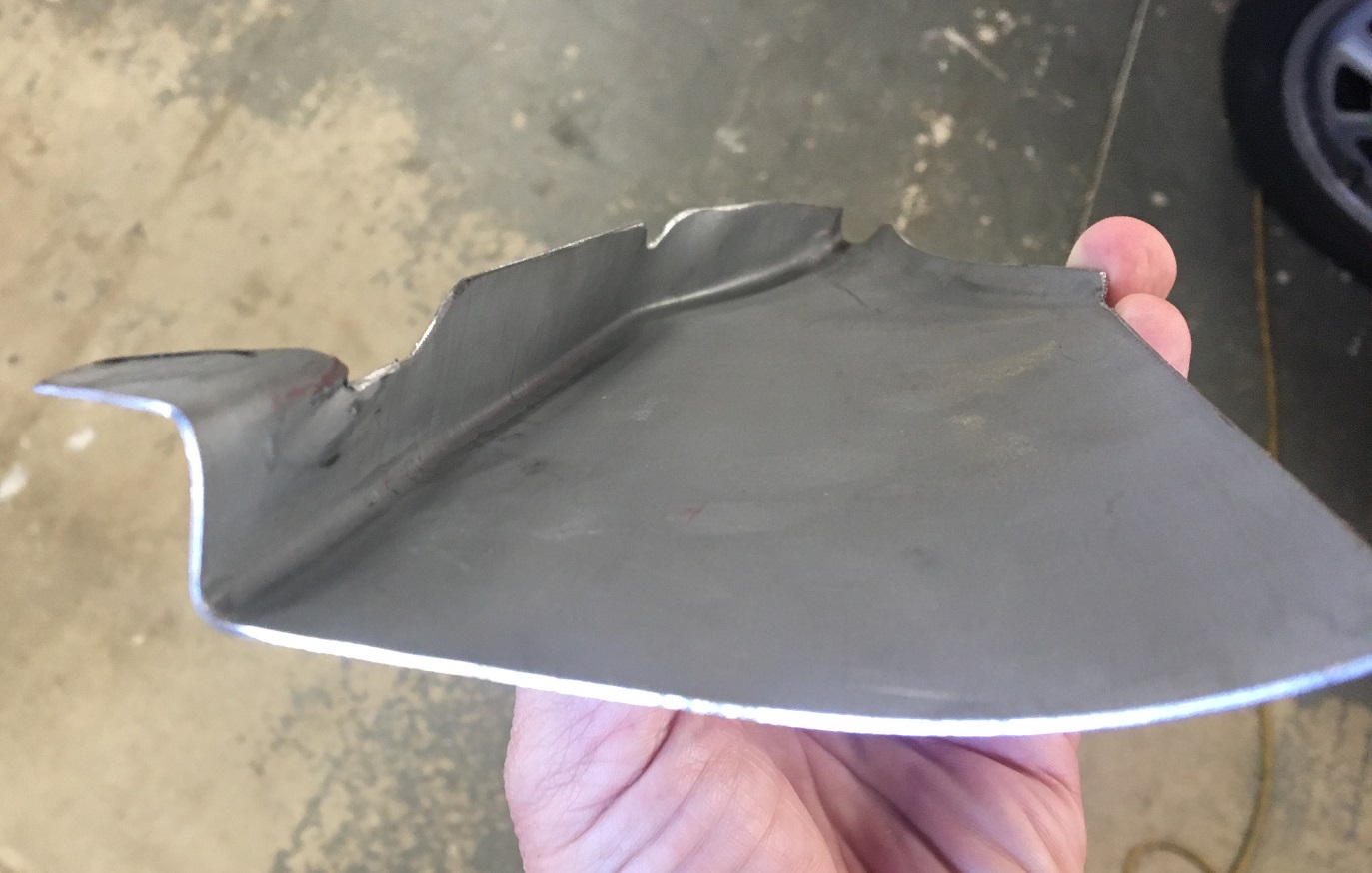

@Cary
Here are a few pictures of the fender patch underside.
Here we can see the dent, near us to the left 1/3 in the picture, causing the back end to lift up. I don't think the 2/3 area is dented, just the fold creating this shadow.
The lines are pretty good when looking a the original piece I removed from the car. Just wished they had folded the door gap edge...
Any final recommendations on the cowl piece? Either I cut across, which minimizes the amount of welding, but there is a risk of trunk line "breakage", or I replace only what is damaged on the car which keeps both the trunk line and the cowl to fender line as i would be welding the new material to unexposed surfaces. Then again, I do need to replace some of the top surface in front of the windshield frame creating a weld parallel to the windshield on the finished surface. Maybe this will cause a lot of distortion... (IMG:style_emoticons/default/headbang.gif)
I am ready to go, just need a little hint (IMG:style_emoticons/default/biggrin.gif) All suggestions welcome (IMG:style_emoticons/default/smile.gif)

cary   Your now into what we/I call the art of massaging ...   Nov 6 2020, 12:08 PM
Montreal914   @Cary Here are a few pictures of the fender patc...   Nov 6 2020, 03:23 PM
cary   I'd say do the cowl section first. Then tune t...   Nov 6 2020, 03:49 PM
Montreal914   I'd say do the cowl section first. Then tune ...   Nov 6 2020, 04:08 PM
cary   Go big. You wouldn't be happy welding that sho...   Nov 6 2020, 04:24 PM
Montreal914   Go big. You wouldn't be happy welding that sh...   Nov 6 2020, 04:33 PM
