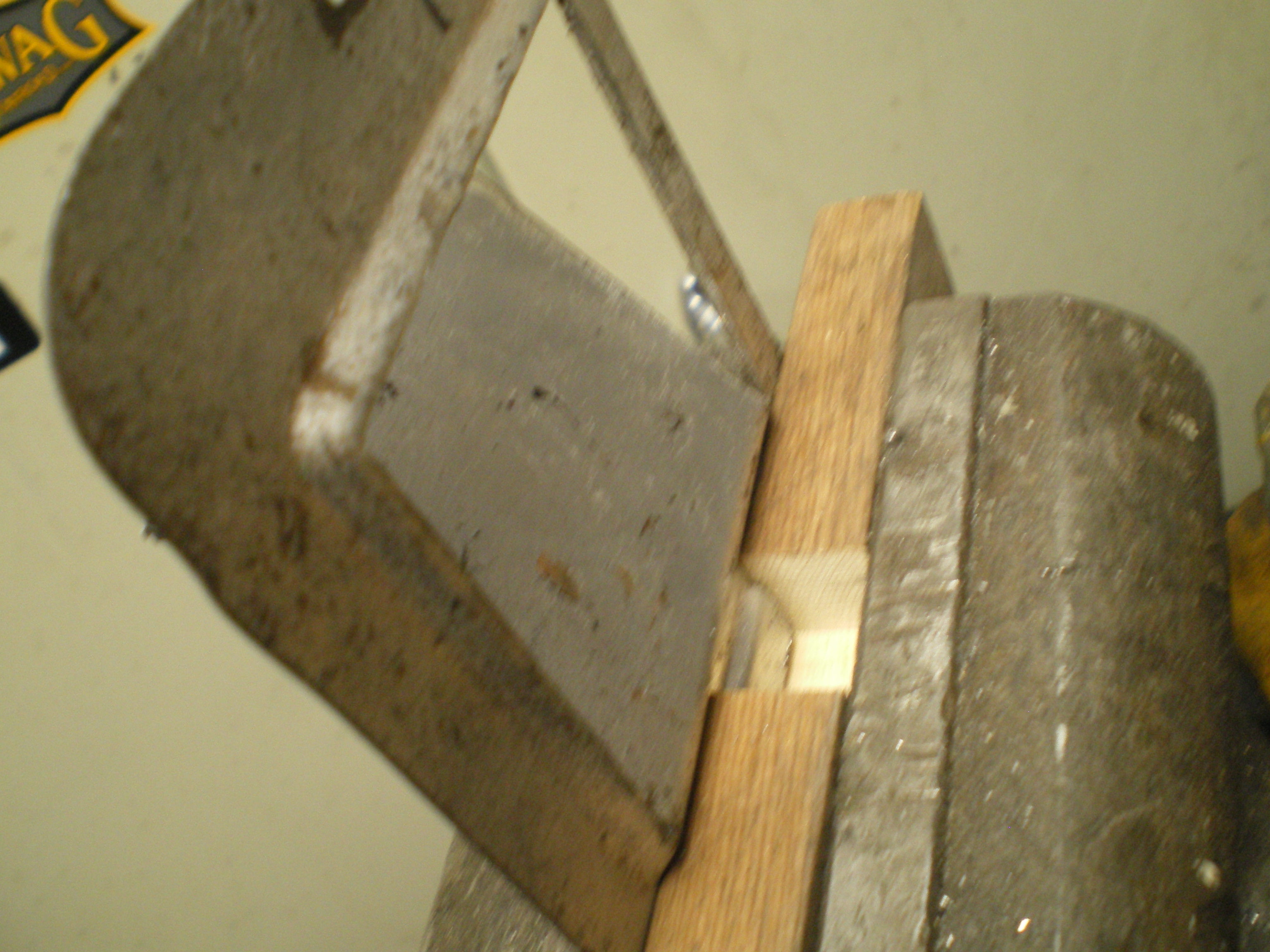

I cut the cover to allow the cables to enter the tunnel.
Then make a couple of small templates for the gussets.
And form the gussets
