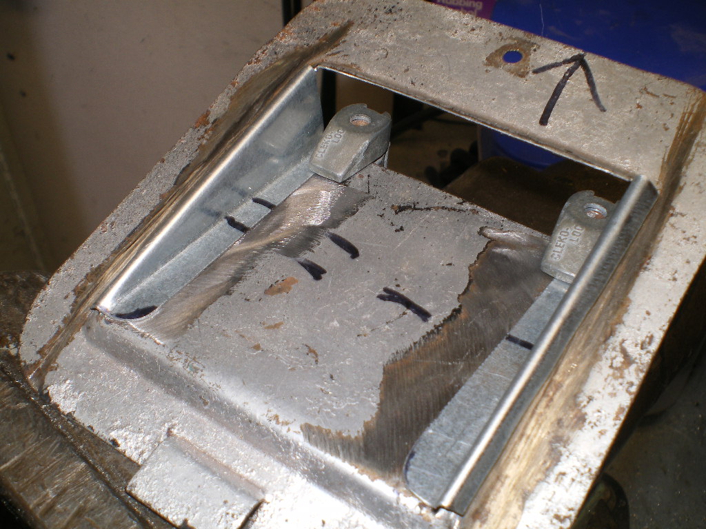

Then clamp together and weld. I use this term weld loosely as I blew a hole in the thin metal and had a couple more spots bulge out on the other side of the weld. I threw some primer on it for now and will hammer down those bulges later.
