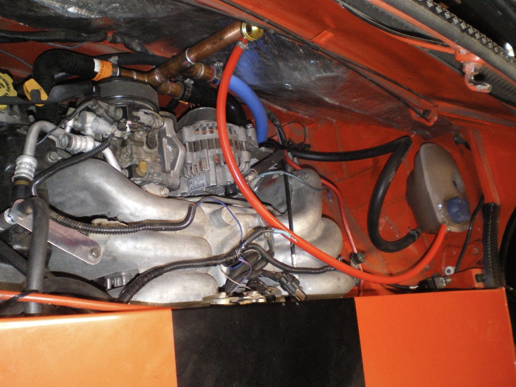

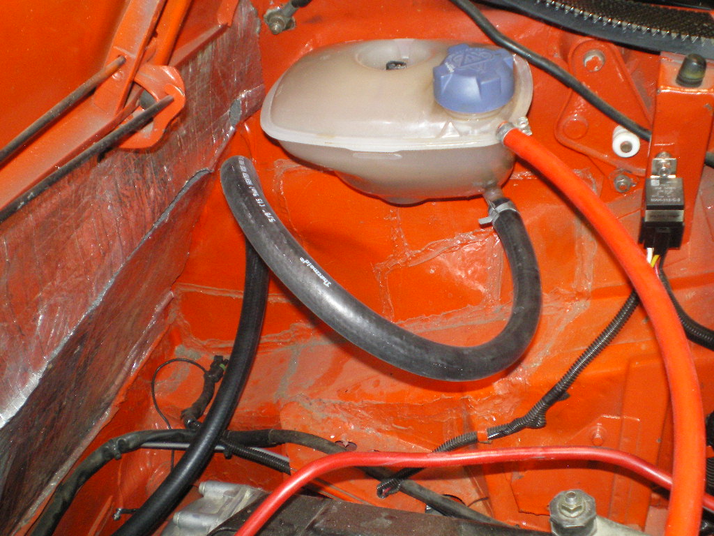

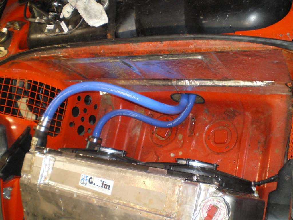

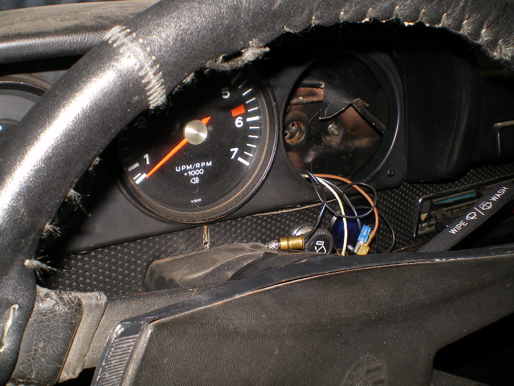

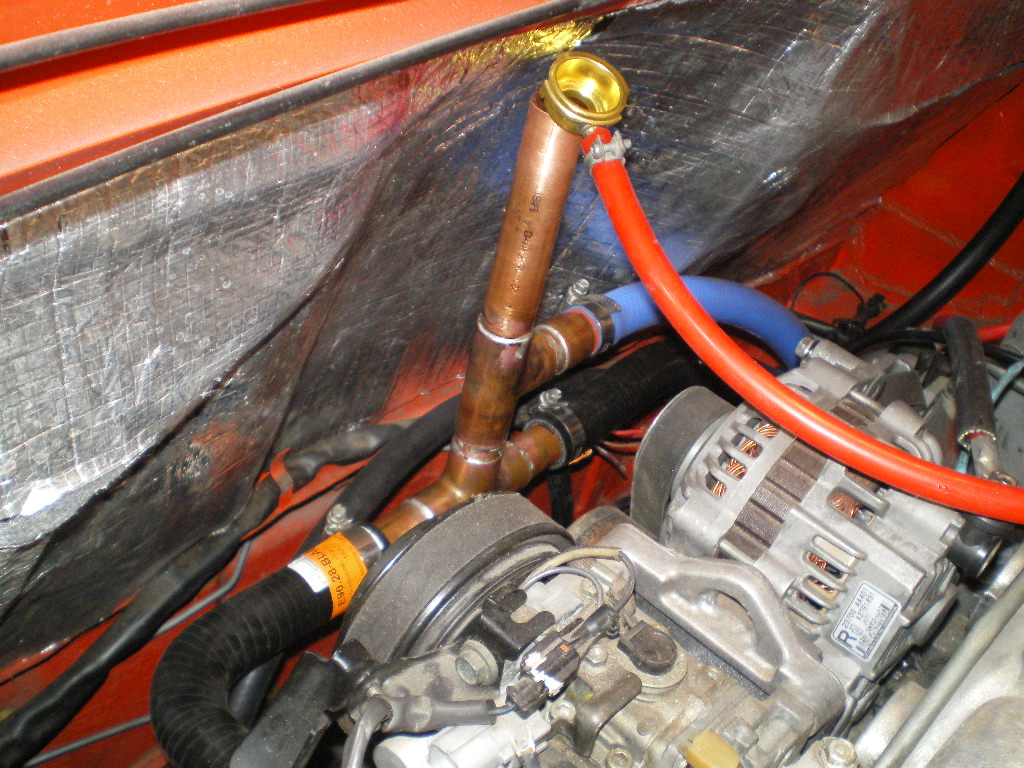

All of the plumbing is completed and tied in with the exception of the radiator filler neck. The one you see on the end of the red silicone hose is just too flimsy so I ordered another that is more substantial. It should be here in 2 weeks. I left all of the hoses a bit long for now. After I've got a few hours on the car I'll cut them to final length.
The clutch is bled and the reservoir is topped off.
And the speedometer should be here in two weeks.
I can see the light at the end of the tunnel. God willing and the creeks don't rise this thing will be on the road by Christmas. To be continued..................
