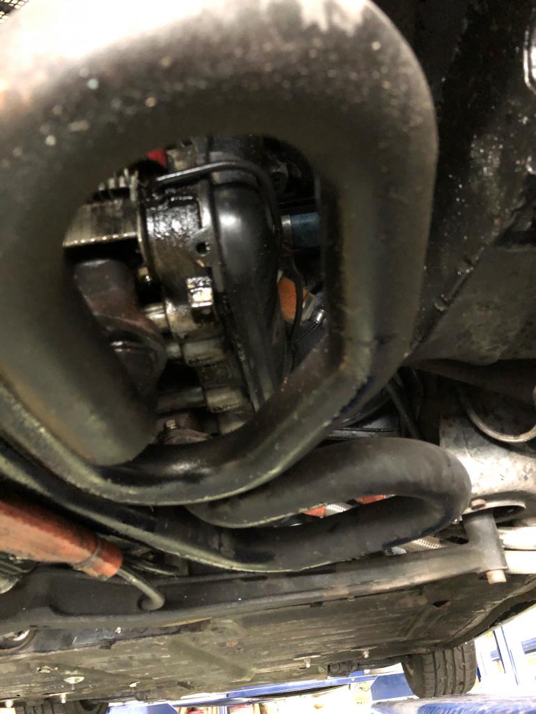

Kablooey! Looks like I’m in the market for a new engine... should I convert to a 6?

GregAmy   What are we looking at? What went kablooey? The T...   Nov 10 2020, 07:50 AM

GregAmy   The pic is of all the oil coming from the top of ...   Nov 10 2020, 09:23 PM

GregAmy   No thoughts on the oil pressure. Greater than zero...   Nov 10 2020, 10:32 PM
infraredcalvin   Well, no such luck on the damage. I dropped the m...   Nov 17 2020, 09:12 AM

brant   those "windows" in the case are a clear ...   Nov 17 2020, 09:39 AM
GregAmy   Ooooowww.... "So what happened?" ...   Nov 17 2020, 12:13 PM

infraredcalvin   Just got off the phone with Dennis at FAT, looks l...   Nov 18 2020, 02:45 PM

infraredcalvin   BTW, the valve head broke off, no dropped seat. P...   Feb 3 2021, 07:26 PM
