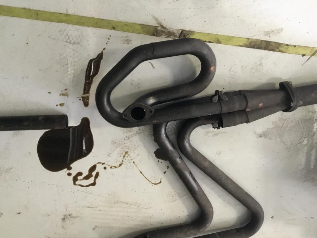

Well, no such luck on the damage. I dropped the motor and the more I dug into it, the more I realized it was not going to be good...
First, there was a about half a quart of oil in my header...

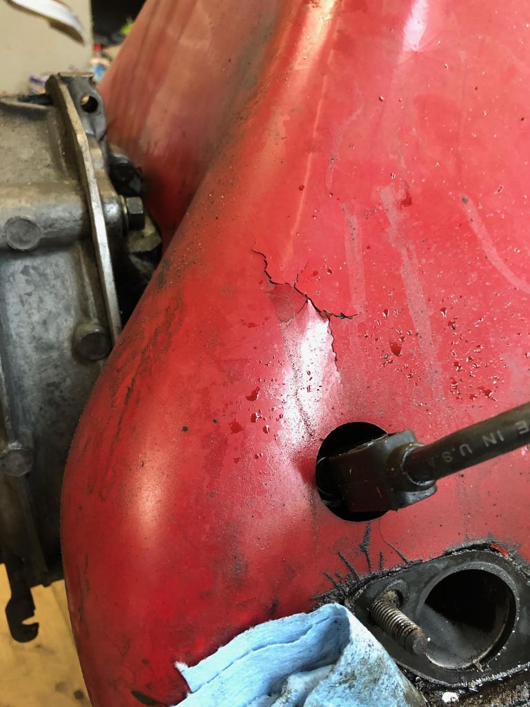

Then I dropped the engine and noticed the crack in the shroud from an impact coming from the inside...

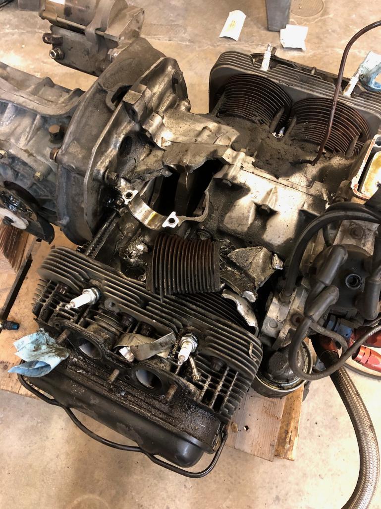

Then all the metal falling out as I took the shroud off...
Looks like I lost an exhaust valve, then all hell broke loose...
