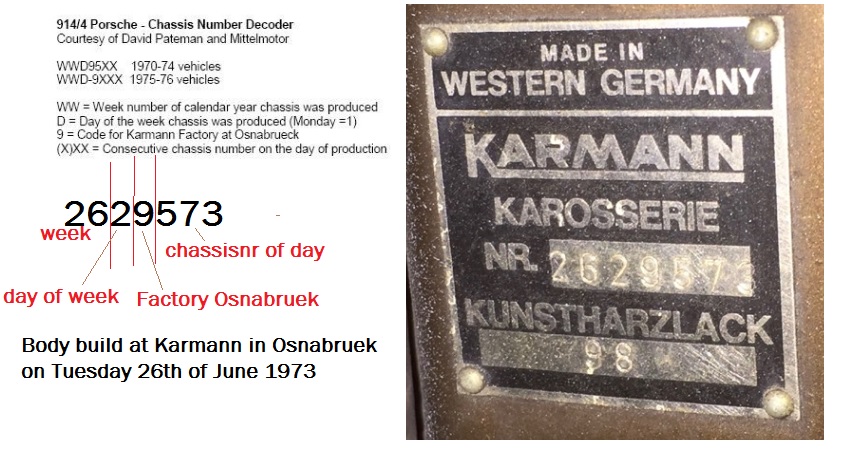

Remind me again where to find production date for our cars?

Hi Ben, I used my Karmann Tag as example, hope it helps a bit to get closer to the date !
mb911   Production dates   Nov 26 2020, 06:45 AM
Frankvw   Hi Ben, I used my Karmann Tag as example, hope it ...   Nov 26 2020, 08:41 AM
mb911   Frank I don't have that tag just the VIN.. Can...   Nov 26 2020, 08:48 AM
Frankvw   VIn between 4742900001 - 4742921370 = 1974 914 an...   Nov 26 2020, 09:02 AM
Arno914   Hi, as far as I am informed, it is the last 2 dig...   Nov 26 2020, 09:27 AM

JeffBowlsby   Good question about the 6xx. Datapoint from the...   Nov 26 2020, 11:16 AM
davep   Thanks for the heads up. Yes, for the 914/4, the K...   Nov 26 2020, 07:17 PM

plutothepointer   if you can't find a Karman production number o...   Nov 27 2020, 02:51 PM
John   The chassis numbers (rear trunk floor and under da...   Dec 3 2020, 10:50 PM
davep   The chassis numbers (rear trunk floor and under d...   Dec 4 2020, 08:32 PM

Arno914   As far as I have learned, John´s car was the 116t...   Dec 4 2020, 01:03 AM

davep   4742910193 should have production month 11/73   Dec 4 2020, 08:20 PM
mb911   4742910193 should have production month 11/73 ...   Dec 5 2020, 09:01 PM
