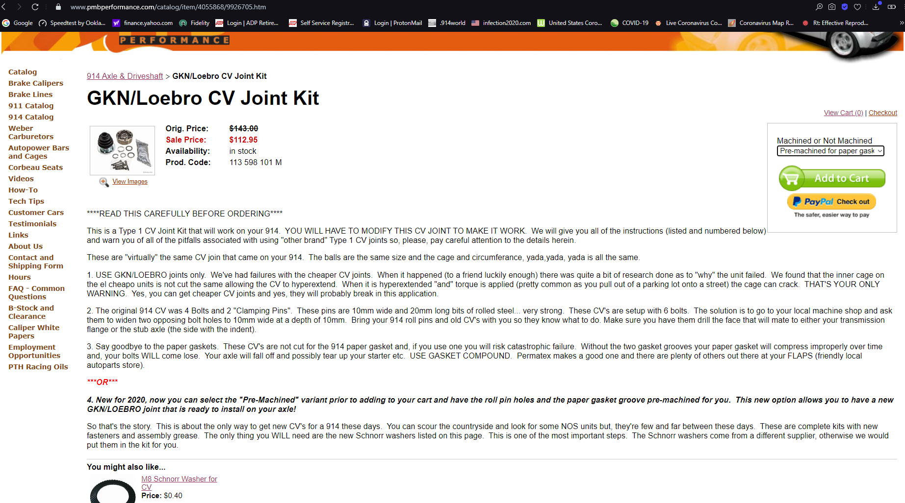

So don't bother cleaning/inspecting/measuring the best "old one" out of both recently purchased axles . . .just buy one pre-machined GK cv joint kit from PMB (feels like 3 out of 4 of my original ones are good)?

914_teener   Yep...that'd be my course if I were you. BTDT...   Dec 3 2020, 07:10 PM

bbrock   And just a little more background that I've de...   Dec 4 2020, 01:38 PM
