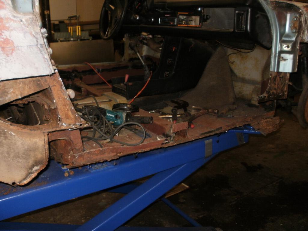

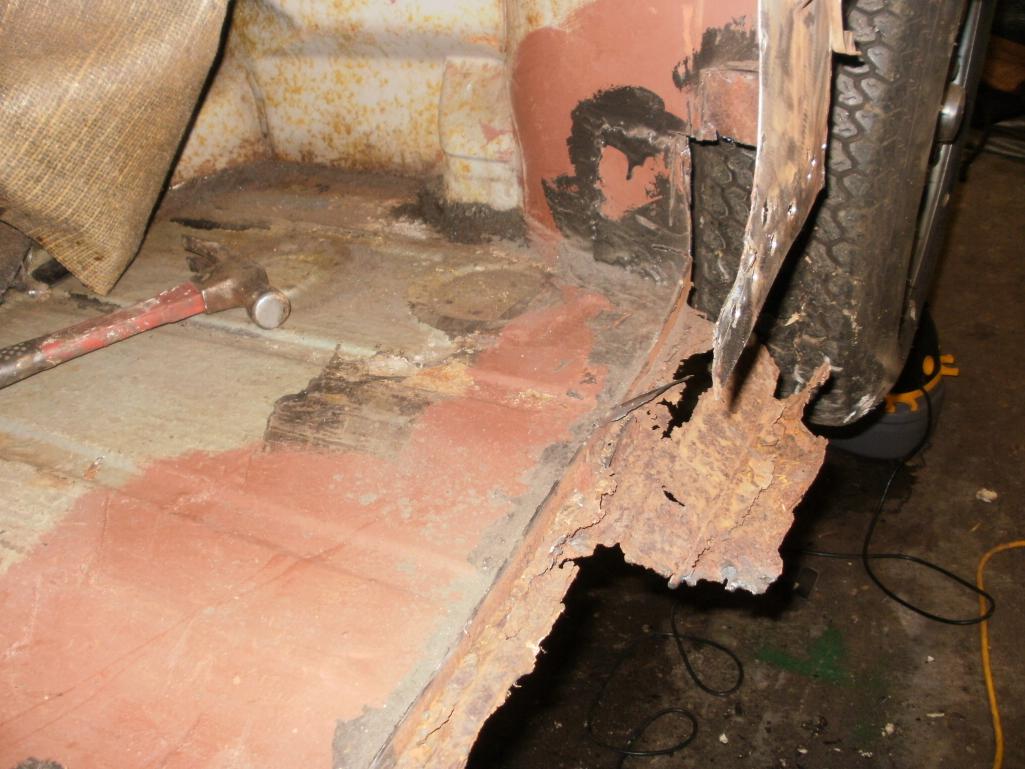

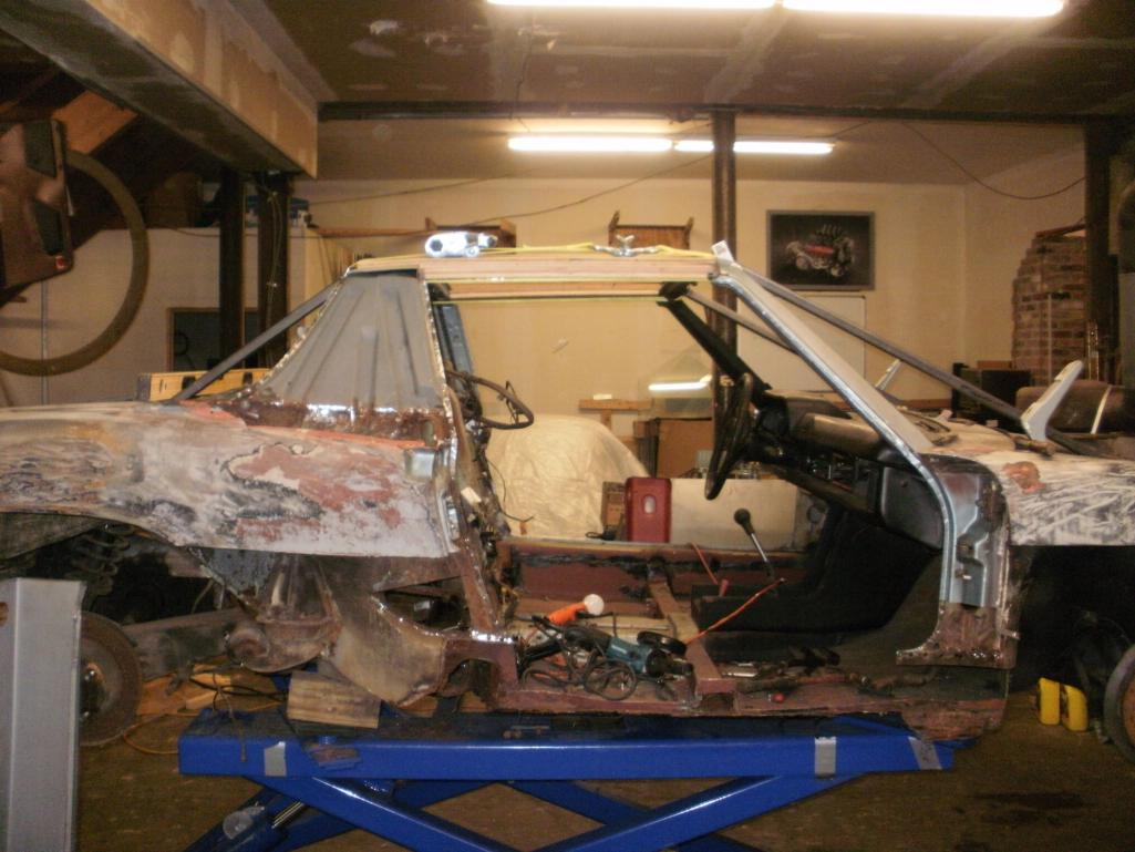

Had some progress in the shop today. I went with a different method of holding the body while she is being cut apart. Old inner long finally gave it up, but not without a fight.
Attached Image Attached ImageAttached Image
