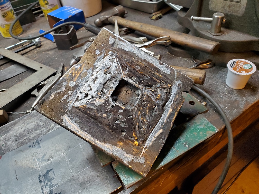

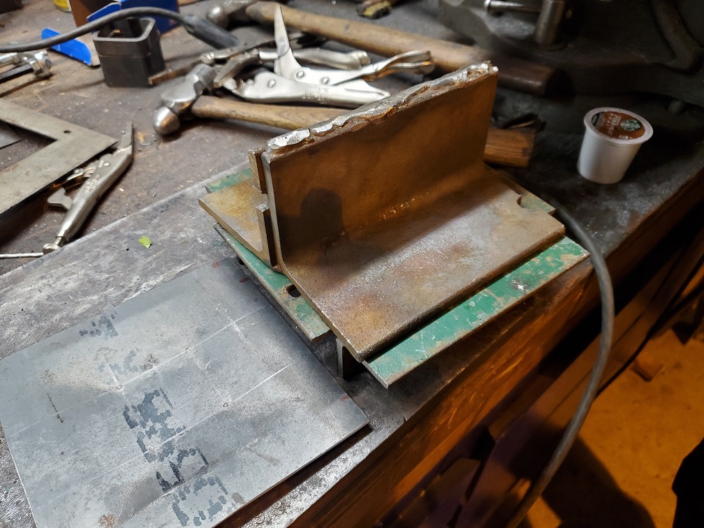

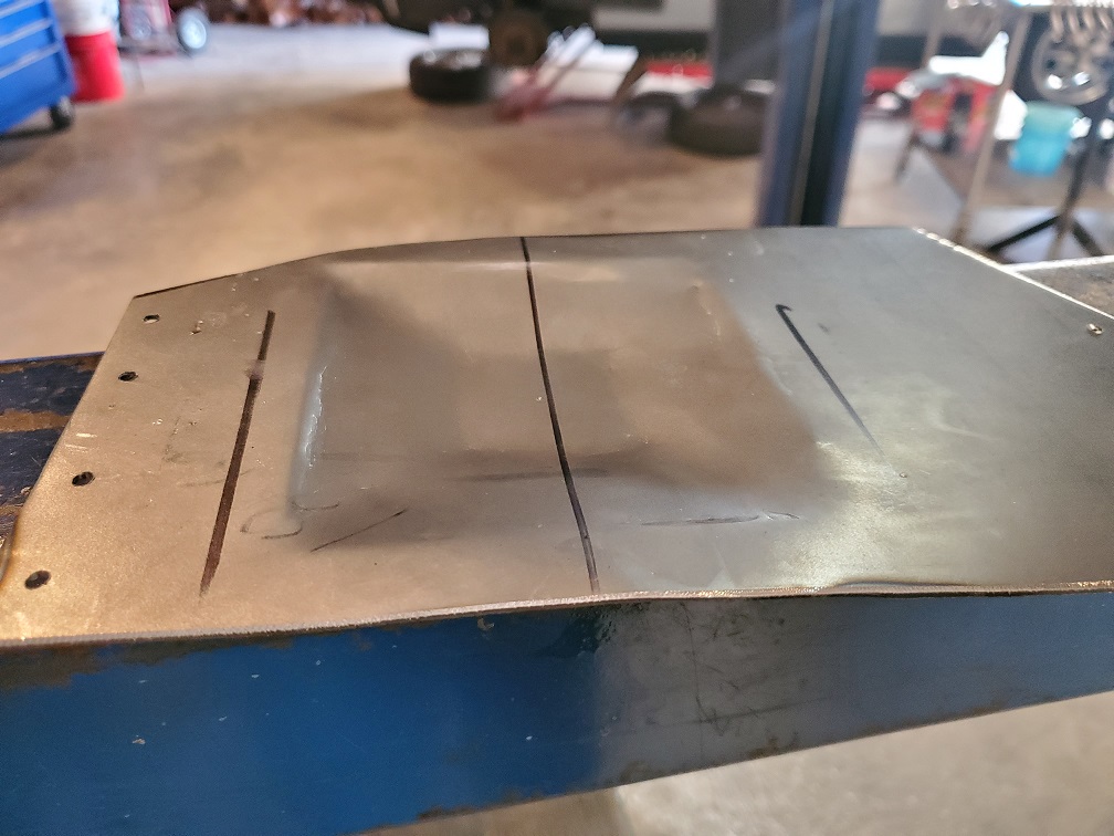

Here's Jack's (Super In Law) latest creation.
Built a tool to press a jack post indentation into 18 ga sheet metal. Primarily for
left side jack post cancer. But still use it on small right side repairs.
Press portion. He did use up some .030 wire (IMG:style_emoticons/default/rolleyes.gif) .
Receiving/pocket portion of the tool.
Pressed into patch panel
