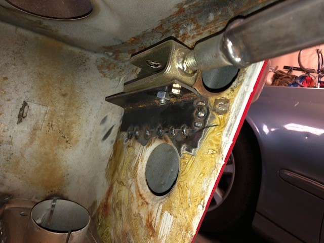

For my door brace, I found an "adjustable link" from Tractor Supply Co, cut it in half then welded it to a thick walled 1" square tubing.
The brace goes from the upper seatbelt bolt hole to a section of angle iron tacked into place on the inside of where the door hinges are, above the heater pipe. Not sure if it was the easiest/cheapest way to do it, but it allowed me to adjust the door gaps with the doors installed.
