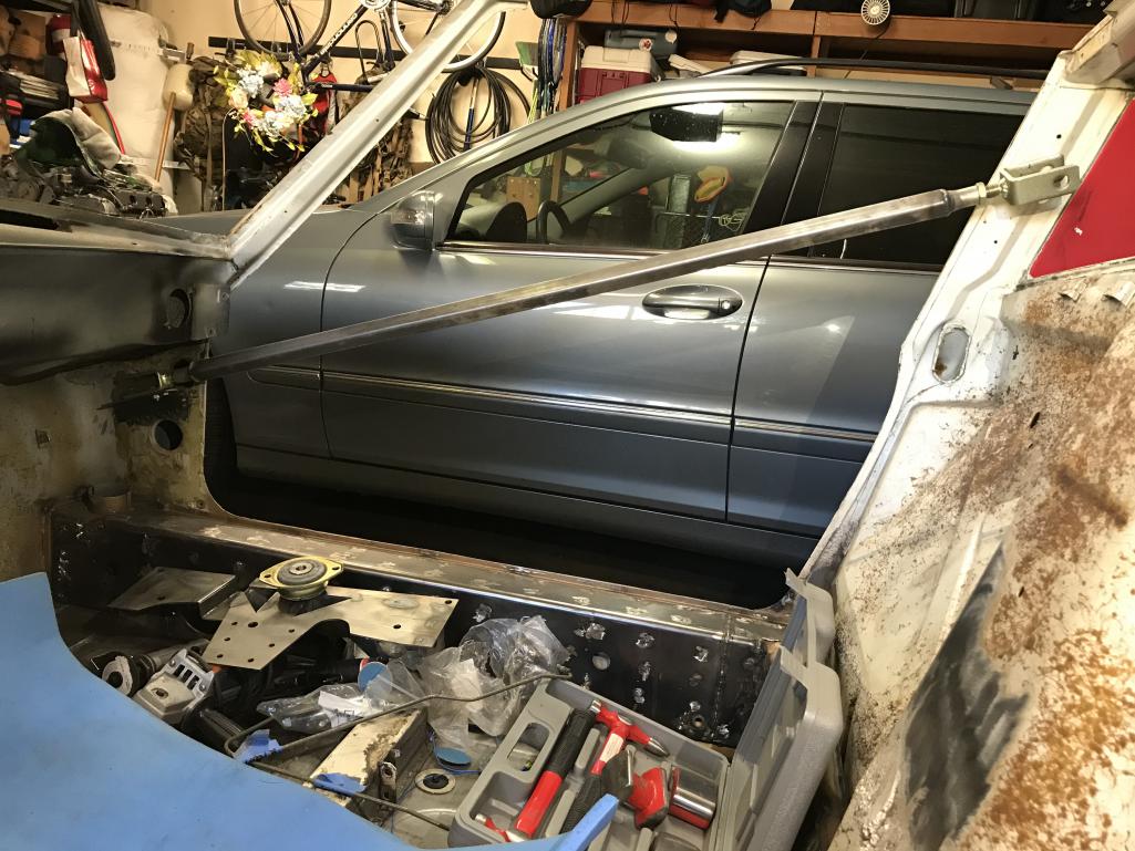

pencap914   For my door brace, I found an "adjustable lin...   Dec 7 2020, 02:52 PM
pencap914   RE: 2.0 or more   Dec 7 2020, 03:00 PM
draganc   What’s the deal with us 914 guys?!?...   Dec 7 2020, 03:14 PM
930cabman   What’s the deal with us 914 guys?!?...   Dec 7 2020, 06:04 PM
VaccaRabite   Is that a "homemade" inner longitudin...   Dec 7 2020, 06:10 PM
