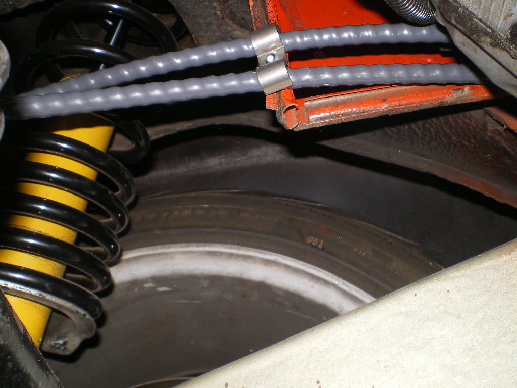

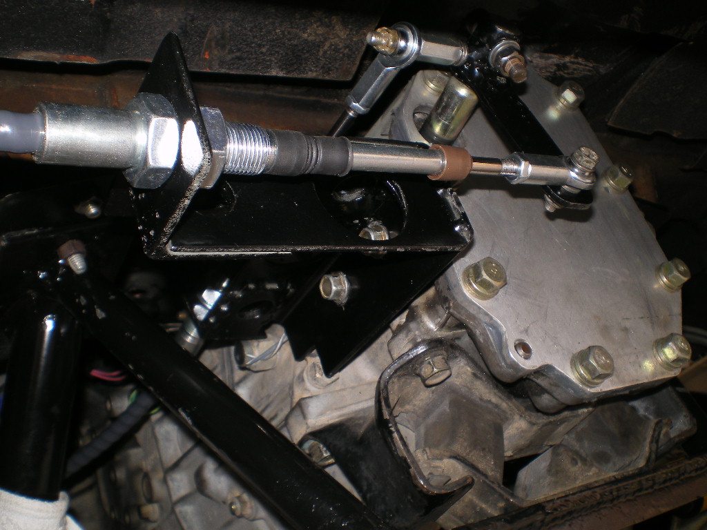

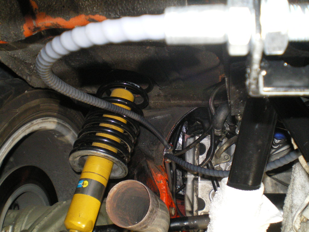

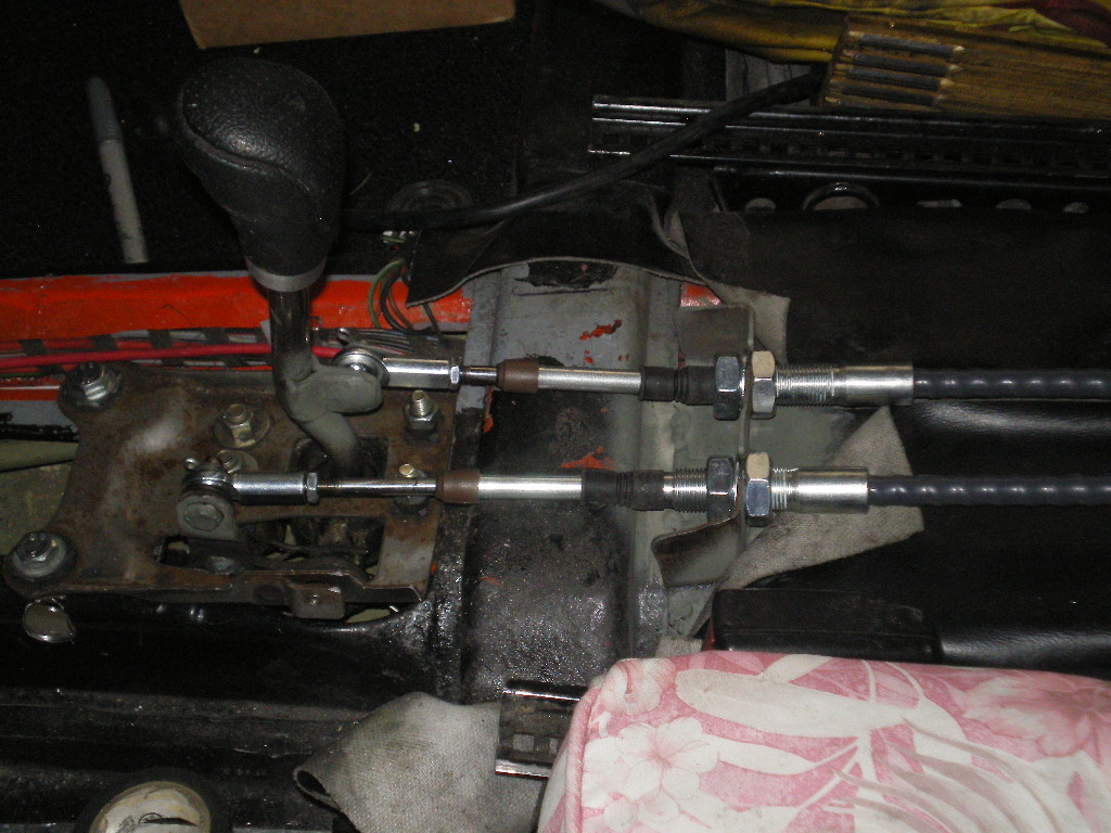

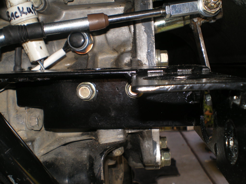

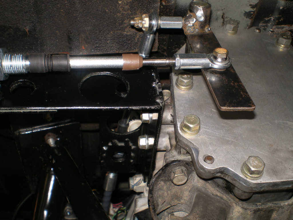

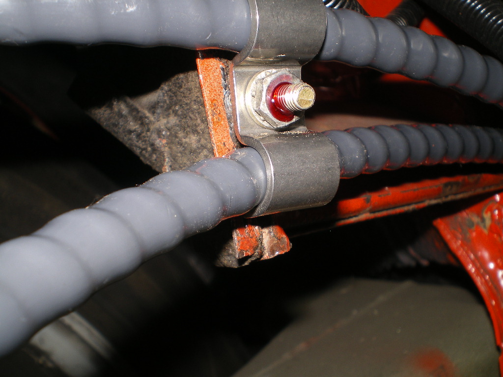

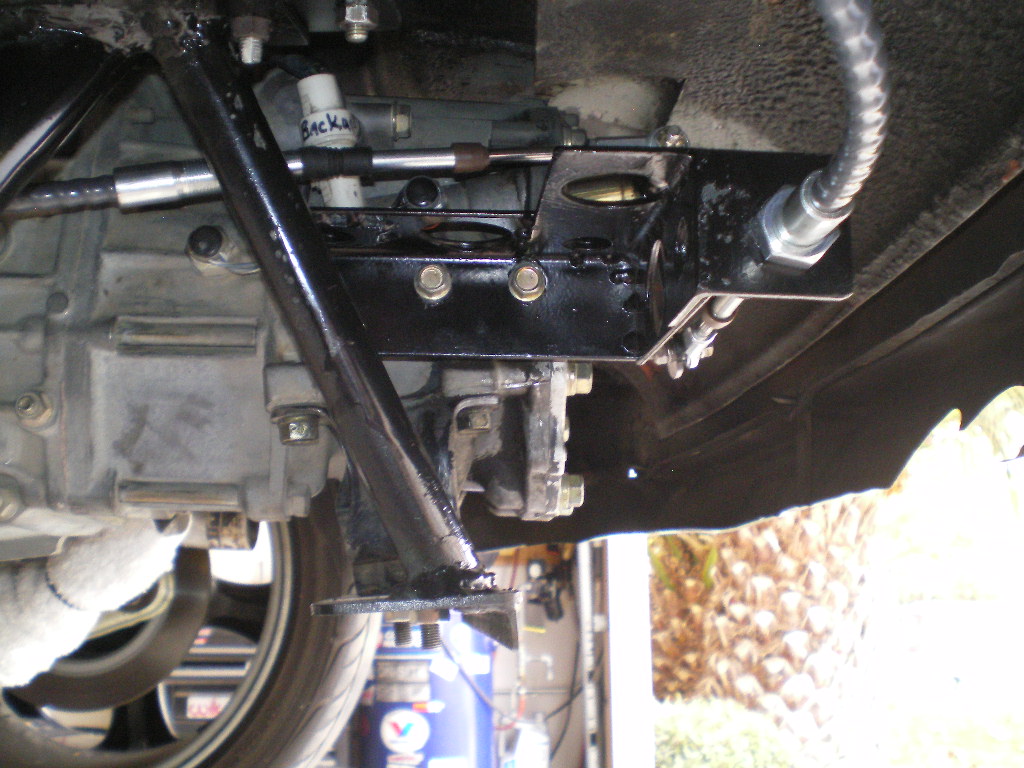

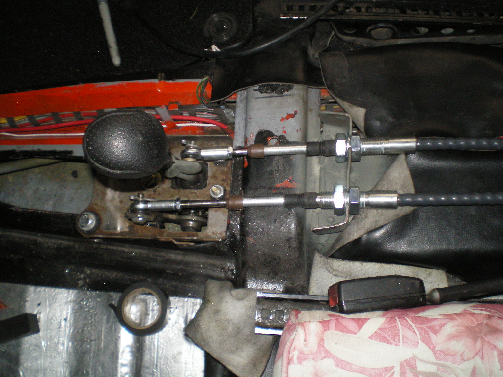

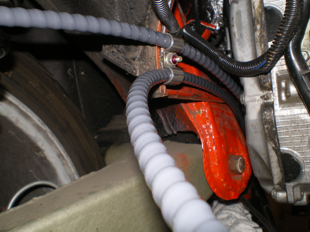

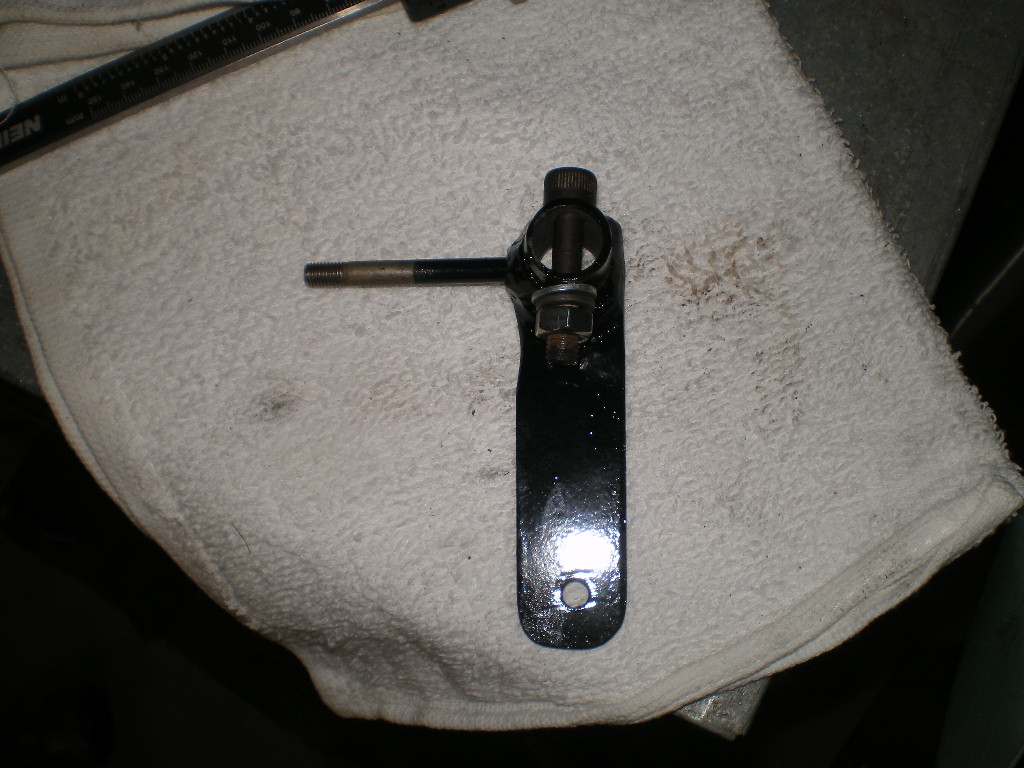

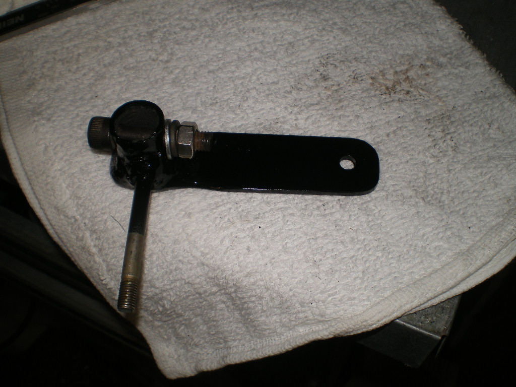

I have some catching up to do here. I received my cables from CCI and they are top notch as usual. In case you're wondering they are 90" & 98" long. Here are a few pic's of them and of the installation.
This lever was made using a scrap piece 1/2" steel pipe, 1/8" plate steel and an AN-3 bolt

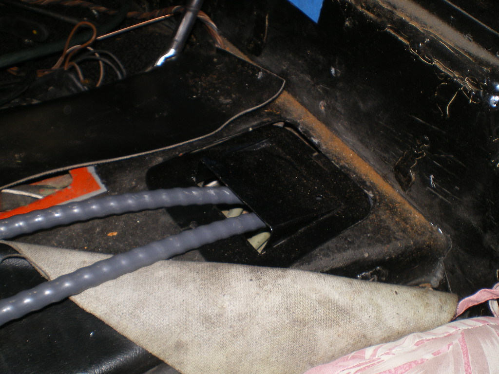

A few shots from inside the cabin.
