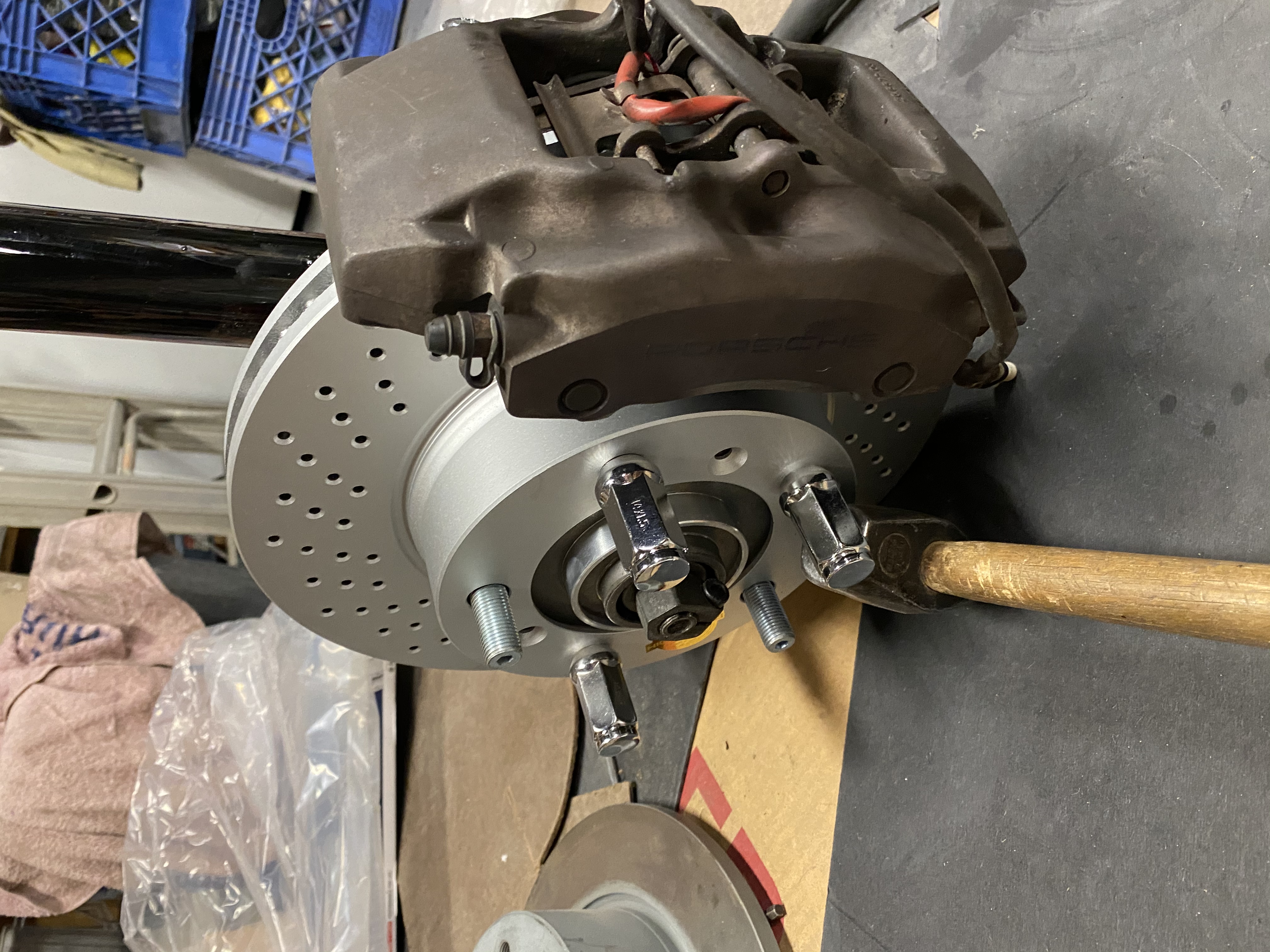

For several years I have been tinkering with a new way to have vented rotors without requiring 911 parts.
I found the Sebro rotors/hubs for the front but they only work with early struts. I went as far as converting a pair of early struts to the later ball joint. This wasn’t a bolt on solution which was my challenge plus you have to order the rotors from the old world and they are expensive by the time they are shipped. In addition if rotor damaged or worn everything must be replaced. Still wasn’t satisfied.
Watching some T3 VW builds with 944 suspension and 901 5 speeds I came across some combinations for brakes that got me thinking.
After several variations I settled on this
Complete bolt on Boxster/Cayman rotor and caliper on the later 914 strut.
Mission accomplished.
