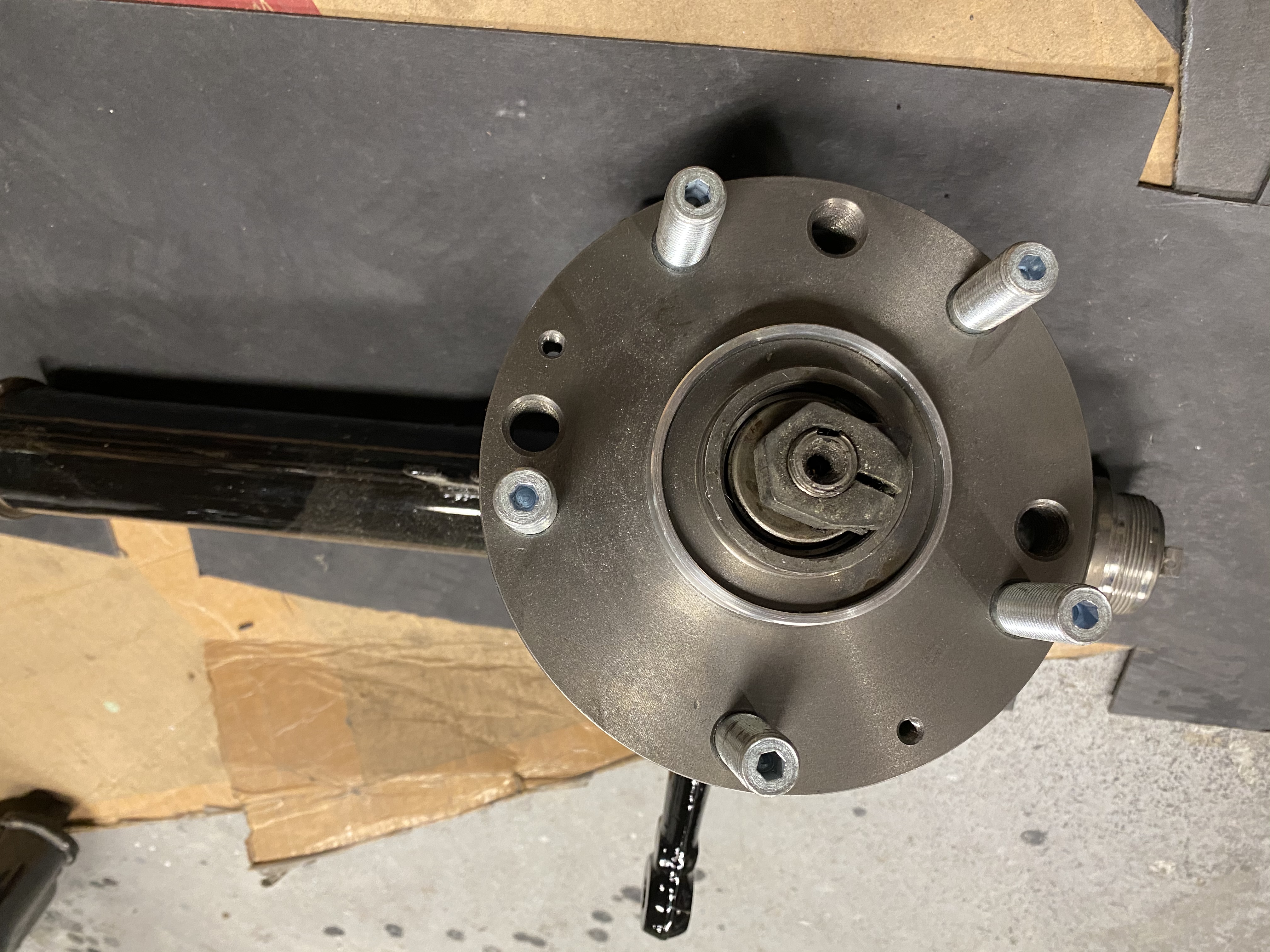

djway   For several years I have been tinkering with a new...   Dec 26 2020, 11:51 PM
djway   I had to have the matching rear rotor/caliper comb...   Dec 26 2020, 11:58 PM

djway   I had to have the matching rear rotor/caliper co...   Dec 29 2020, 08:17 PM
djway   Da hub.   Dec 27 2020, 12:06 AM
djway   Da hub. The front hub can also be had in alumi...   Dec 28 2020, 11:35 PM

808 WRX   What if you could get a 5-lug rear hub that's...   Jan 3 2021, 01:14 PM
UROpartsman   Hi guys, it's part number 914 331 605 5 LUG; f...   Jan 12 2021, 12:04 PM
DRPHIL914   Hi guys, it's part number [url=https://apaind...   Jan 12 2021, 12:28 PM
UROpartsman   does this require a different bearing than we norm...   Jan 12 2021, 02:05 PM
914werke   Hi guys, it's part number [b][url=https://apa...   Jan 12 2021, 02:13 PM
djway   My name isn’t Pete but it’s good information. ...   Jan 12 2021, 03:18 PM
