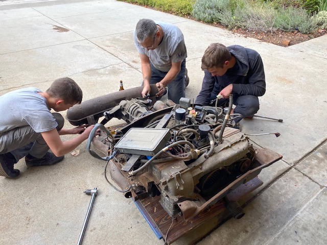

Engine out in a couple hours with the help from my boys and a friend in town from Texas.
You have all seen this before. Lot to do in here.

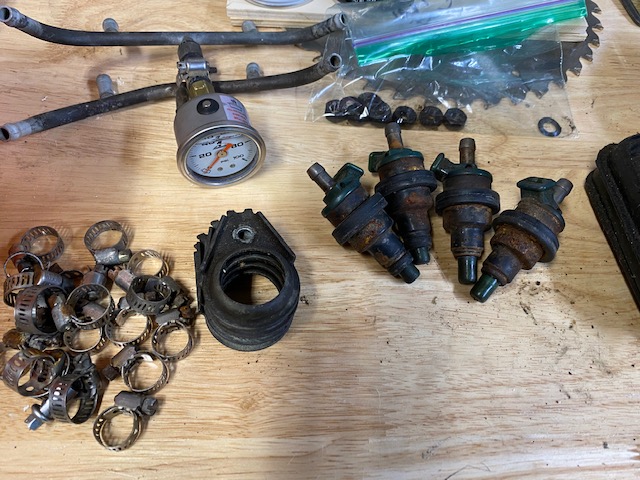

Injectors are rough looking but sending these out to Mr Injector. These were all working up to the time I started pulling the car apart.

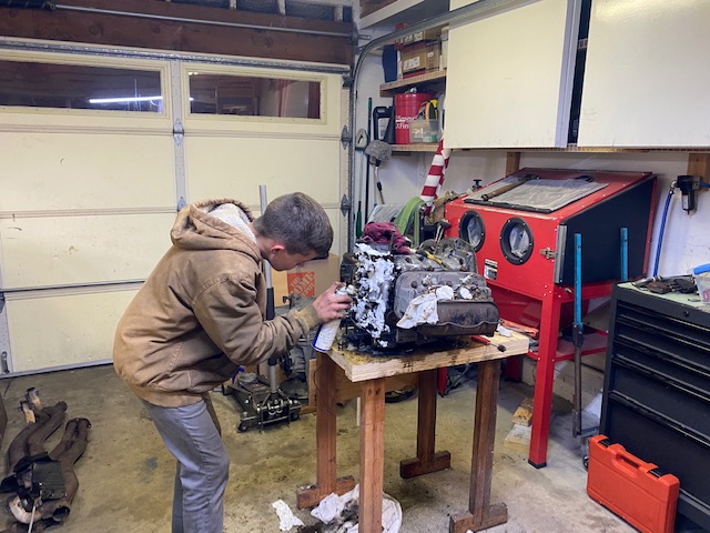

My son cleaning things up. Luke is no stranger to engine to working on engines.

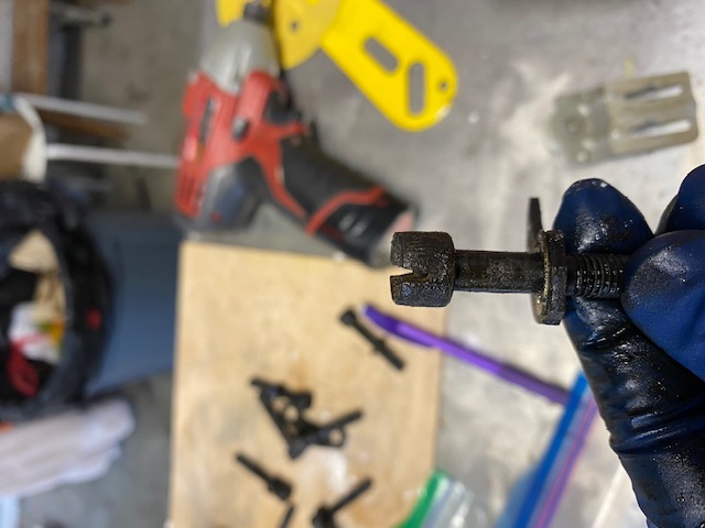

No wonder why I could not get the triple square into these. Obviously will need to replace.

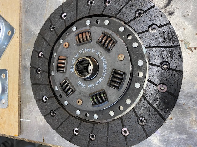

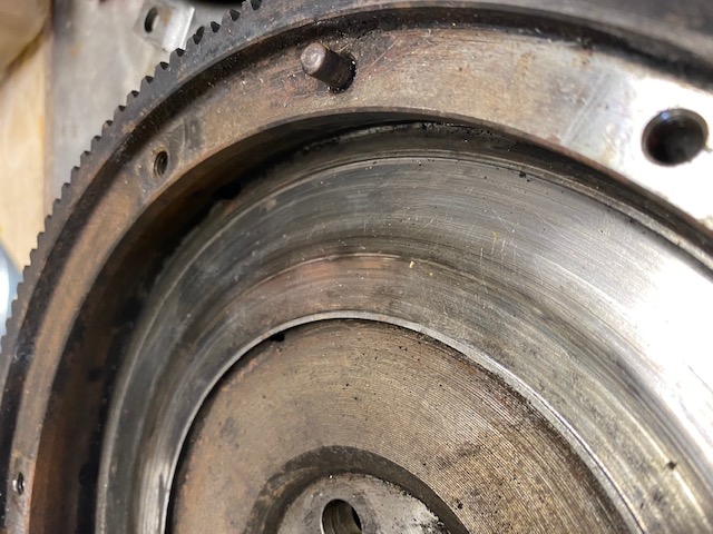

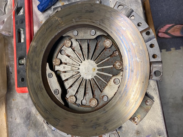

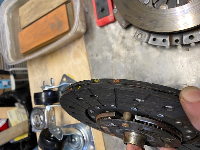

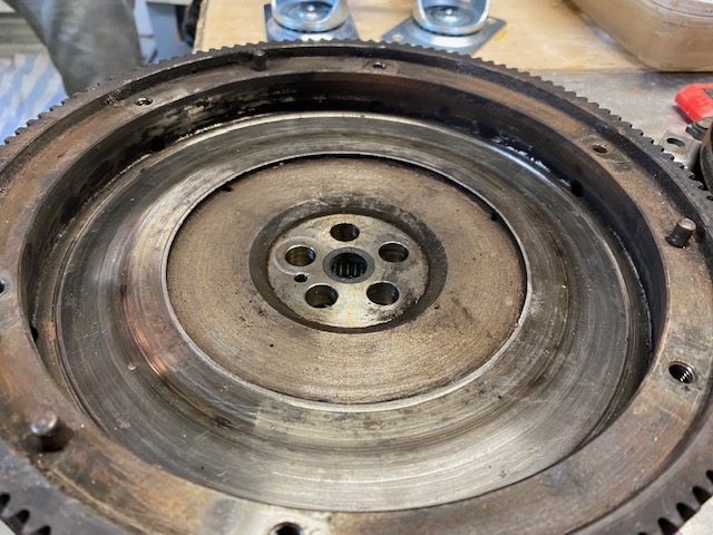

The clutch appears to be nearly new but the flywheel looks like garbage. Throw out bearing is clean as well. Anything to be concerned about here?

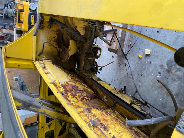

Working on bracing the car today and cleaning up the engine bay.
