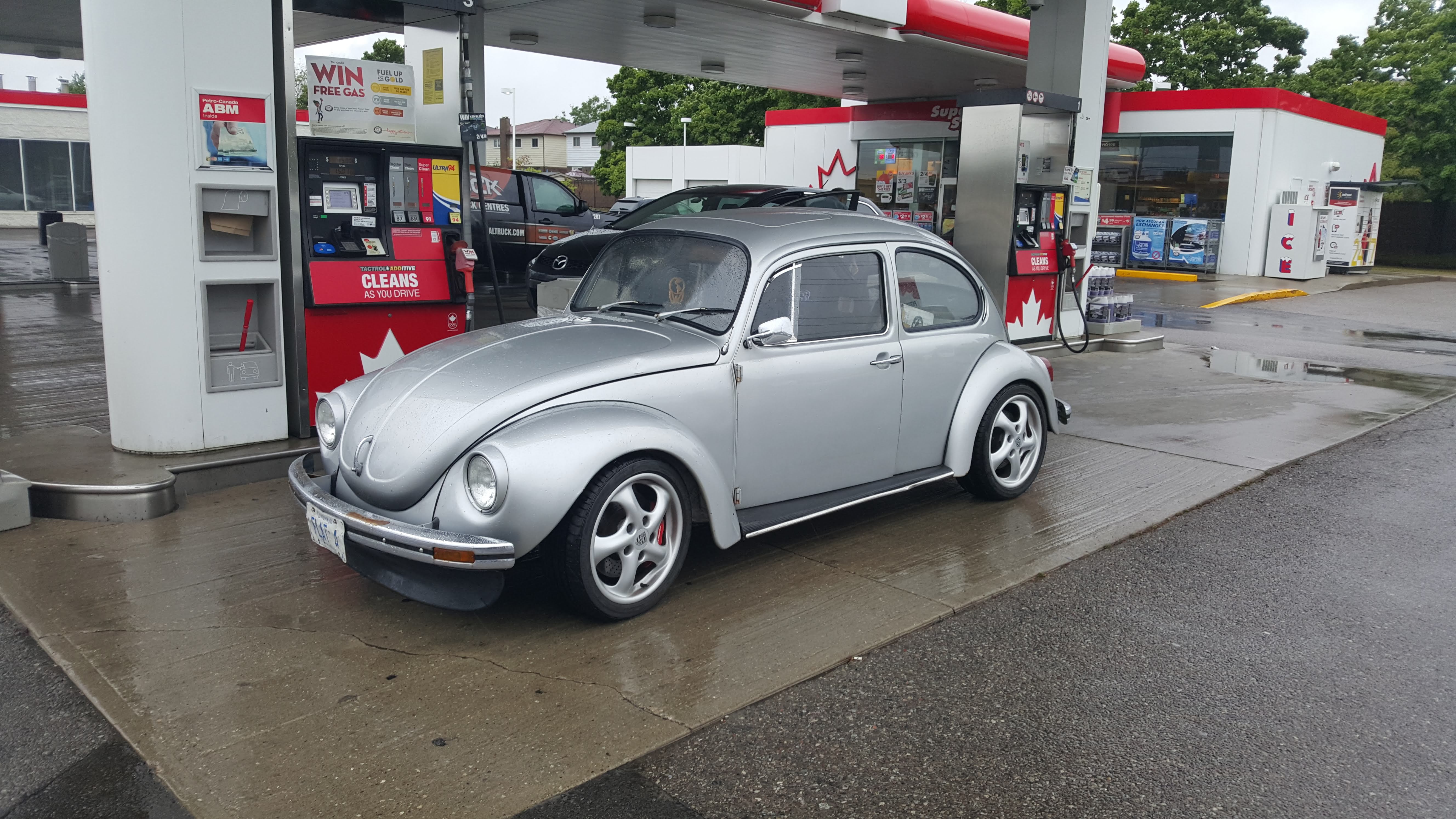

Lanner   Here's a VW I built on the same brake setup, 1...   Dec 30 2020, 01:29 PM

Lanner   I agree mepstein, you are adding unsprung weight. ...   Dec 30 2020, 01:37 PM
