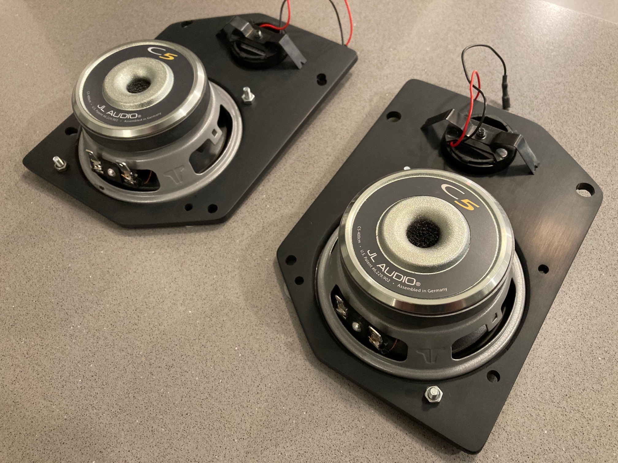

A bit of test fitting. May use rivets for the mids, as many OEMs do, but we'll see.

horizontally-opposed   Okay, back to a relatively simple but good enough ...   Jan 11 2021, 11:24 PM
horizontally-opposed   A bit of test fitting. May use rivets for the mids...   Jan 11 2021, 11:28 PM
IronHillRestorations   A bit of test fitting. May use rivets for the mid...   Jan 13 2021, 11:11 AM
horizontally-opposed   With the speaker enclosure plan coming into view, ...   Jan 11 2021, 11:36 PM
Rob-O   Those mids in the adapter plate look way too deep ...   Jan 13 2021, 12:47 PM
horizontally-opposed   Those mids in the adapter plate look way too deep...   Jan 13 2021, 12:53 PM
914forme   :agree: but I had also thought about building a sm...   Jan 13 2021, 01:13 PM
Chris914n6   I had to flip your end result and mount the tweete...   Jan 13 2021, 02:08 PM
horizontally-opposed   I had to flip your end result and mount the tweet...   Jan 14 2021, 09:36 AM
