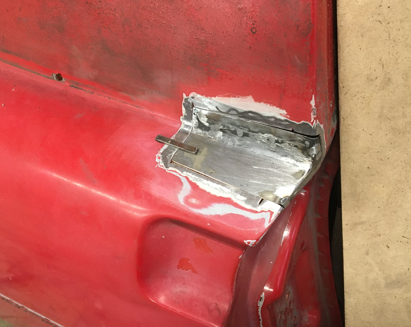

Time to switch to the rear fender of that same side. Another classic, the base of the sail panel. There was a couple of bubbles in the paint, so I wasn't surprised to see rust there.
I cut out the bad area and removed the seam sealer packed underneath and around the vent tube.

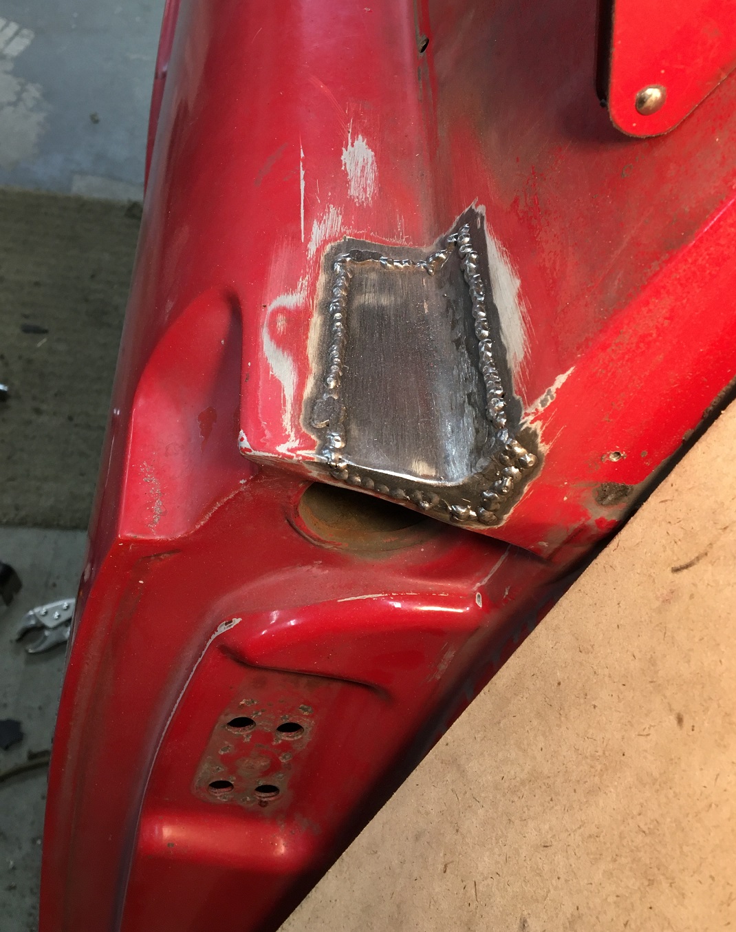

Then, prepared a repair piece and trial fit
Weld and finish up. I have to say that after fixing the cowl area, this is easy (IMG:style_emoticons/default/smile.gif)
