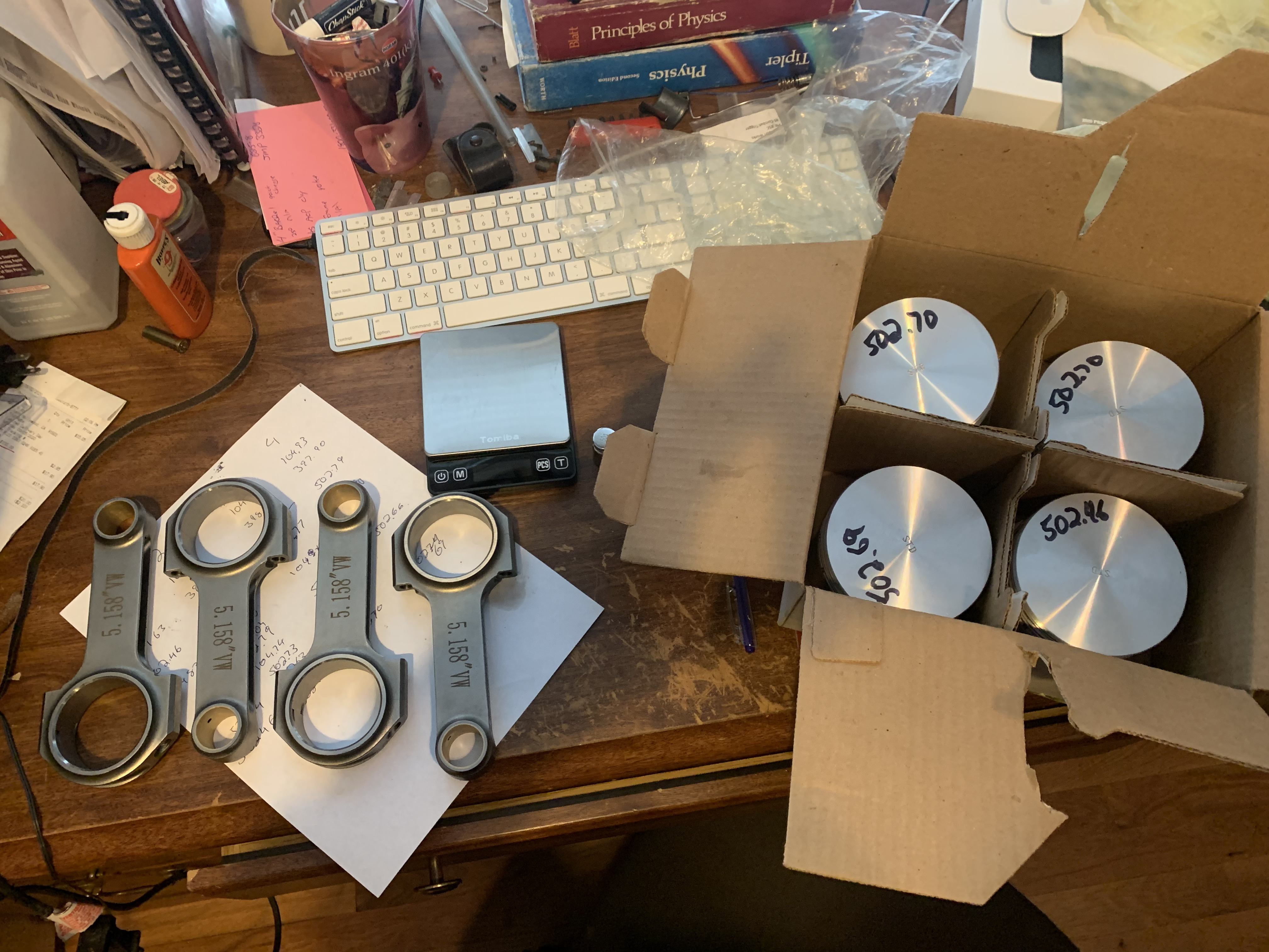

Today I started the engine balancing of the pistons. These are Keith Black 96 mm Pistons and were pretty close.
1) Weigh the pistons and list lightest to heaviest
2) Weigh the piston pins and list lightest to heaviest
3) Match pins to rods for average weights
All in grams
Pins:
1)104.85
2)104.82
3)104.75
4)104.93
KB Pistons
1)397.63
2)399.16
3)398.30
4)397.90
Final Piston and pins (after a little work)
1) 502.46
2) 502.70
3) 502.70
4) 502.69
For those with time on their hands , Will get the last .2 grams on the next pass of balancing because I have Free Covid time at home
