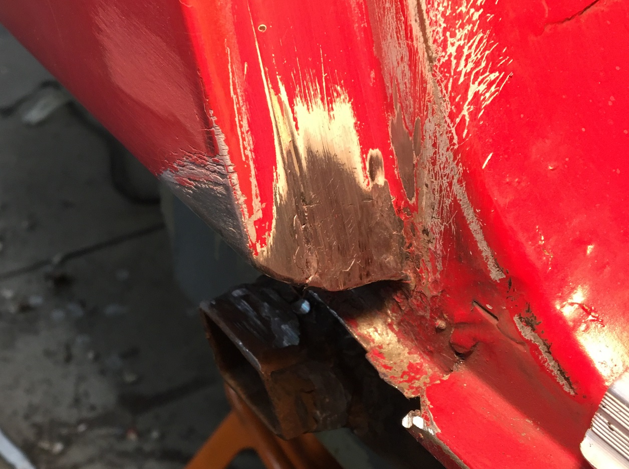

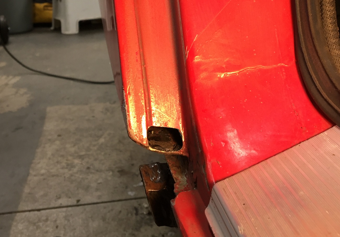

I am trying to understand the construction of the rear part of the fender, more precisely the area joining the front cowling.
Below is a sketch of how I think it is made but i would like someone to confirm...
Having removed the seam sealer in the upper rear area, I have discovered "this" (IMG:style_emoticons/default/dry.gif) which is not really unusual, but clearly a pain to fix. I am not sure though what I am looking at. If my sketch is correct, I guess the inner rusted layer is from the fender rear bulkhead that actually becomes an inner layer on the rear upper point of the fender by the door and cowling junction.
I might be able to cut this from the underside preventing me from cutting the outer surface of the fender. But I would like to better understand what is happening at the junction to the body.
How many layers are there from the fender, one or two?
Is the metal peeling off at the joint to the body the metal from the bulkhead/inner layer, or is it the outer fender layer?
As a reference, this if the situation of the channel, surface rust, but how bad? Is there a way to better know without destroying? Maybe poke with a screwdriver? (IMG:style_emoticons/default/confused24.gif)
Comments appreciated (IMG:style_emoticons/default/smile.gif)

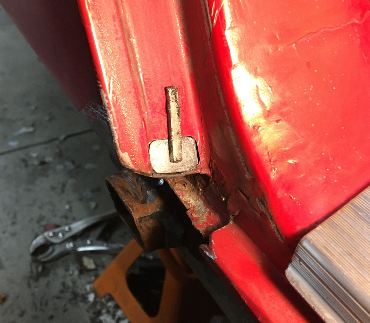

This weeks update:

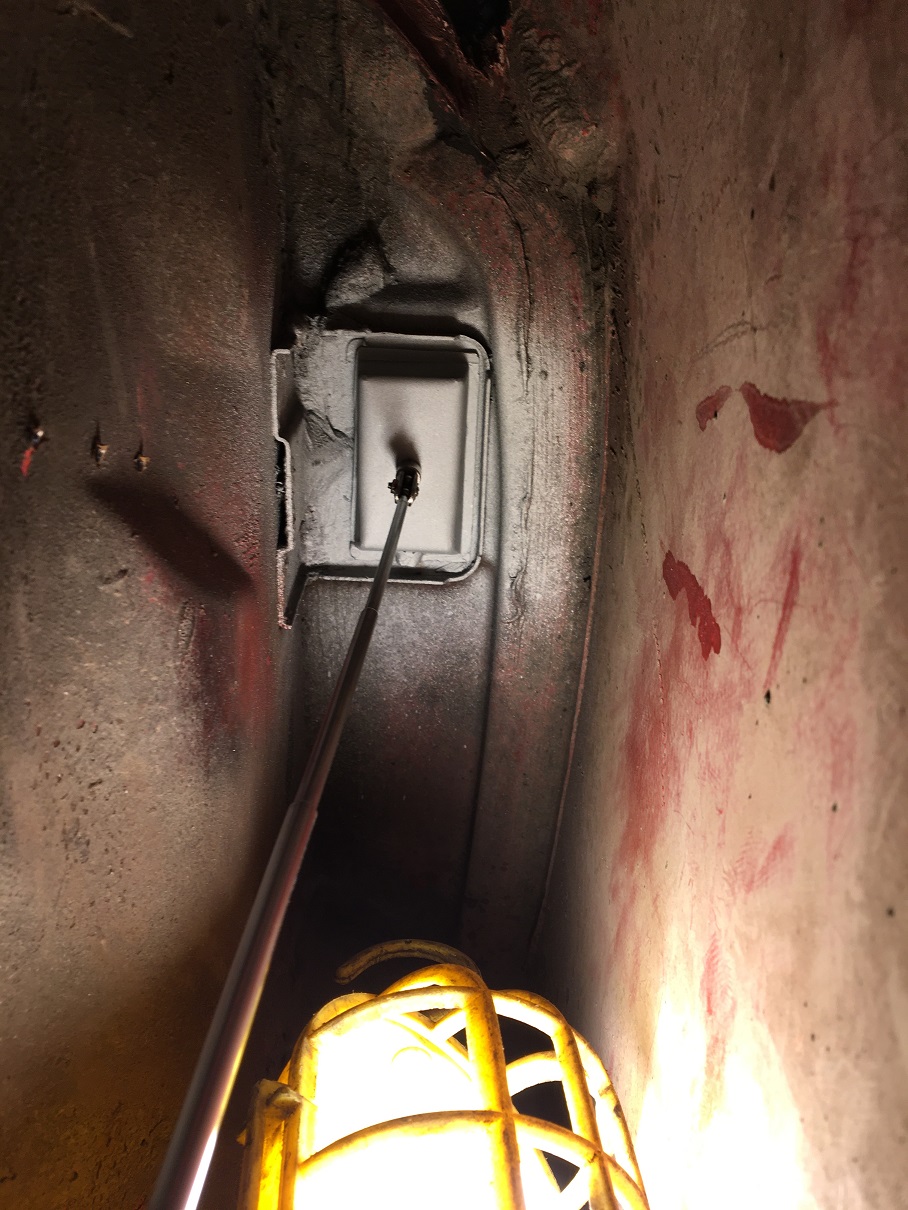

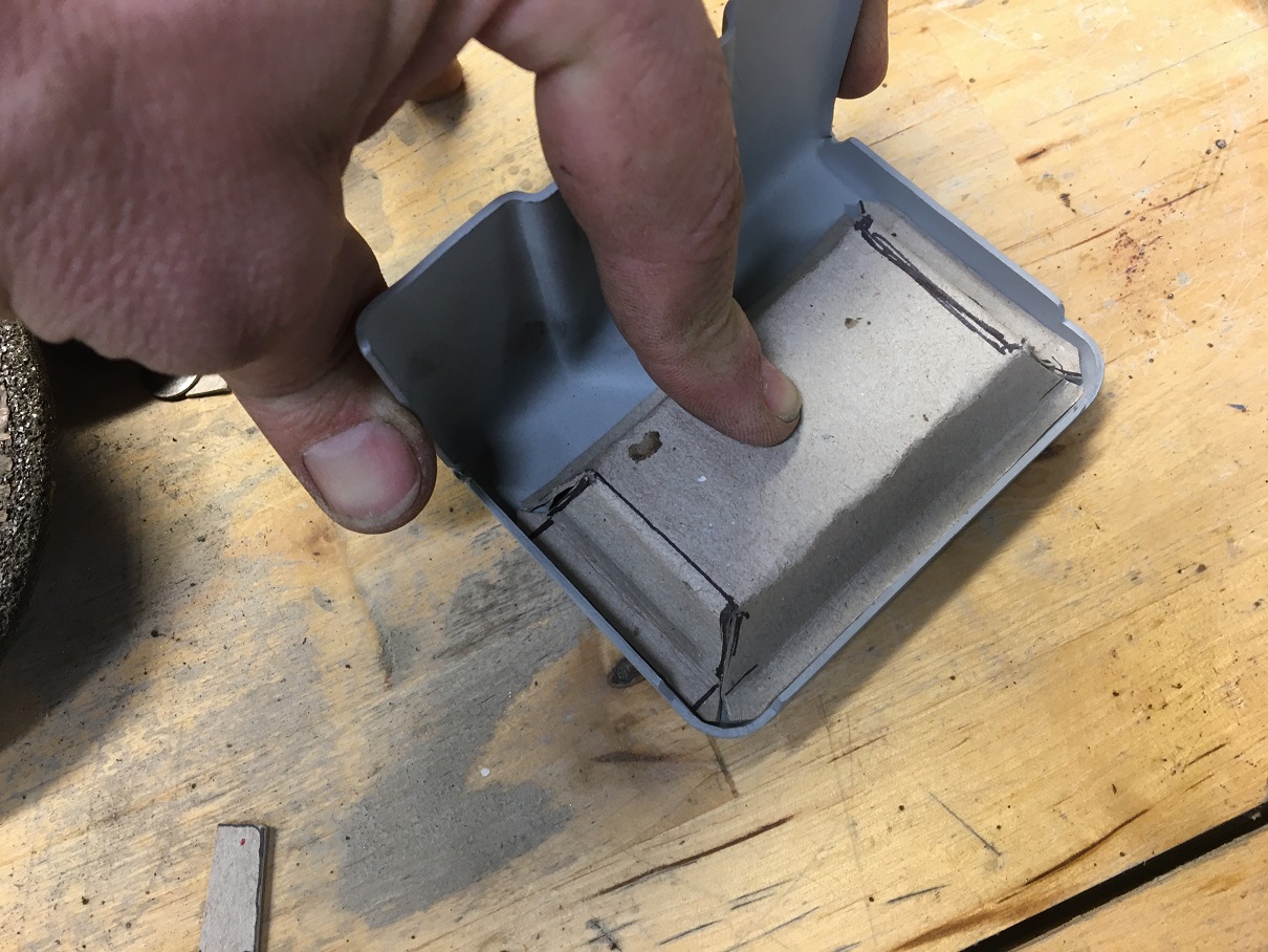

The door latch bracket deep in the rear fender well needed some help. The cover was rusted on the bottom half. After removing it and threating the area with Ospho, time to start rebuilding.
Now with weld through primer and the threaded piece held in place. Good thing i kept on reminding myself to put it there before closing the cover without it, that would have been no fun...

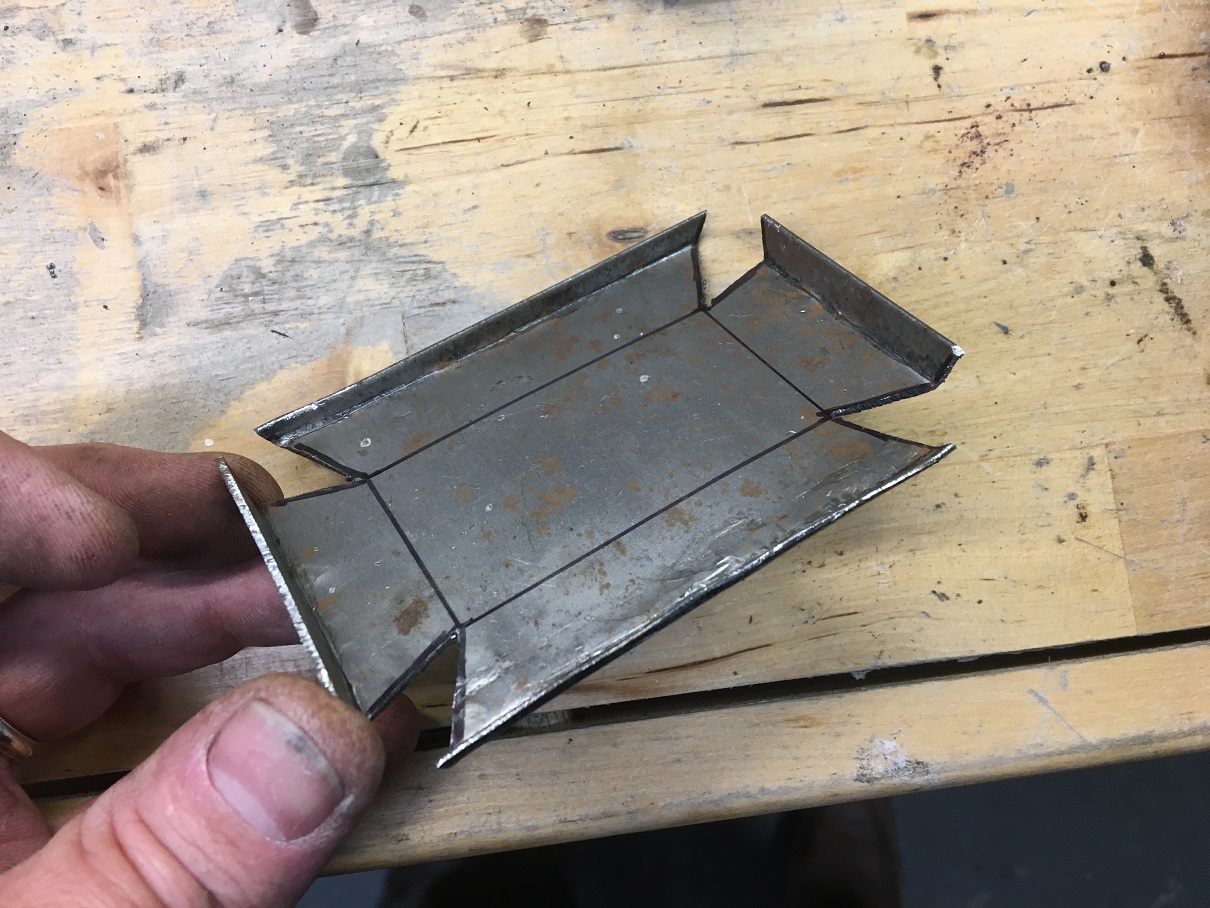

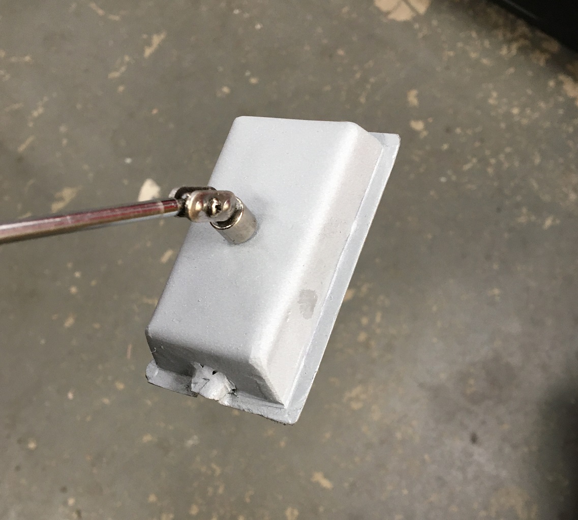

For the cover, I elected to make my own with a template I did, shown here on a spare bracket that didn't end up using.
I added a lower opening to spray in some rust protection with a tube later on. Then spray painted with weld through primer
Then held it in place with my telescopic magnet, ready to stretch and weld it afar with my left hand... (IMG:style_emoticons/default/rolleyes.gif)

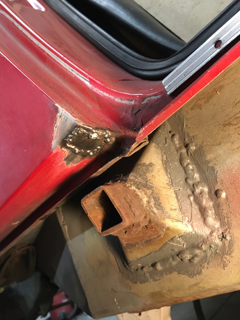

Moving on to the lower fender corner. The one packed with that darn seam sealer that makes things rust... (IMG:style_emoticons/default/headbang.gif)
First the lower part: Repair piece, welded, then finished...
Then the front part: same process...

Montreal914   Next, time to fix some of the scars created during...   Feb 24 2023, 07:37 PM
Montreal914   OK, so let's continue with this problematic lo...   Feb 24 2023, 08:03 PM
bob164   Great progress Eric, thanks for the detailed photo...   Feb 24 2023, 08:05 PM
Cairo94507   Great work Eric; a thing of beauty when the new qu...   Feb 25 2023, 08:57 AM
