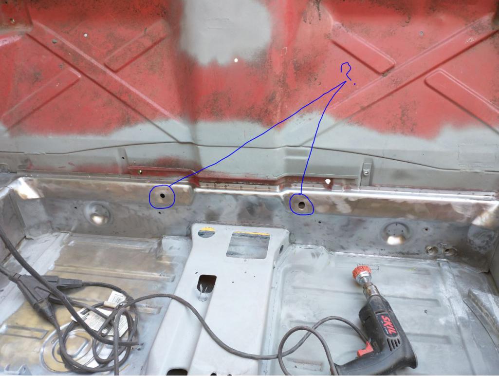

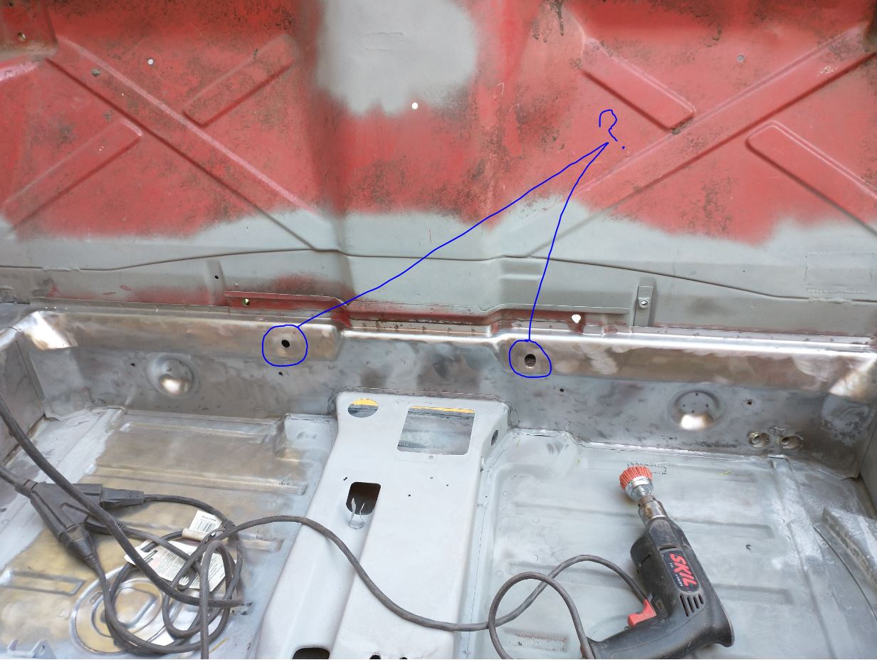

Does anyone know if these two holes should be there? They go all the way through into the engine bay. The one on the right side seems wallowed out and a bit oval. This car seems to have a lot of random, strange holes in odd places...
