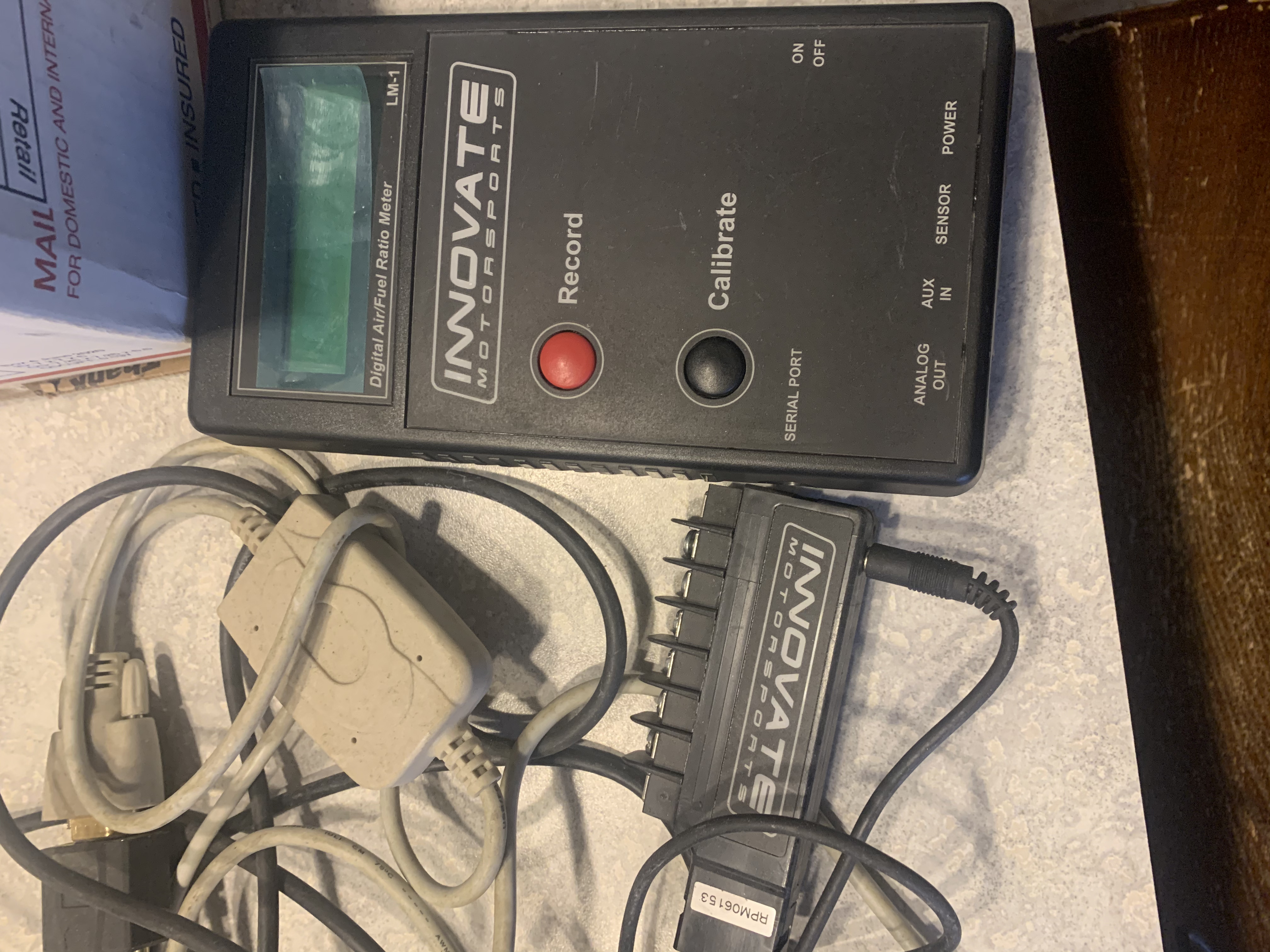

Today: Some of my parts are arriving....
My Flywheel shipped from LJ engineering , Pressure plate and disk are in transit and this arrived today;
This may be the Proverbial Cart before the Horse
But was too good a deal to pass up! With Weber tuning this will give the user a MAJOR leg up, and save me the inverstment cost in jets and parts!
