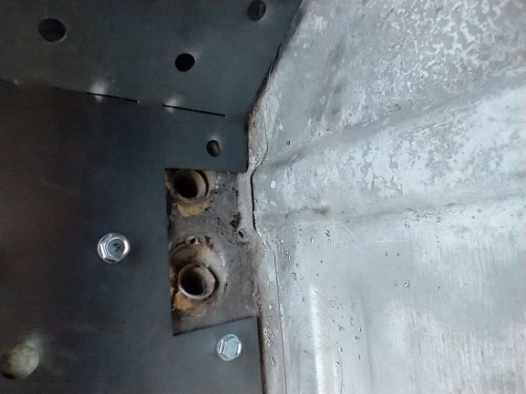

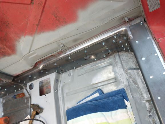

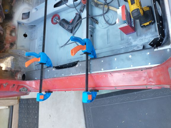

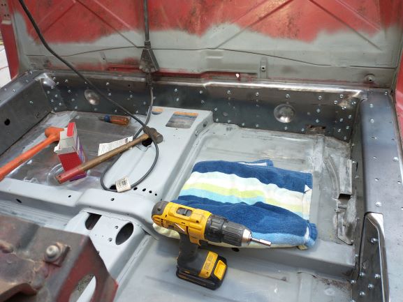

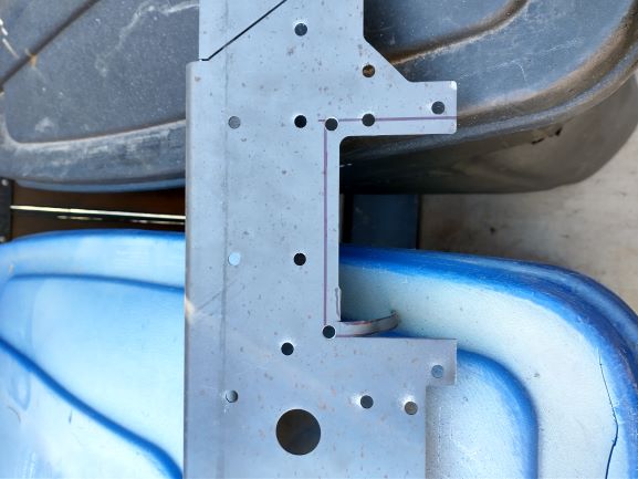

While I'm waiting for more weld-thru primer to get here, I started trying to fit/mold the Mad Dog inner long bracing. I ran into a couple of minor issues. I think my replacement handbrake pivot is a slightly different size than the original.
Looks like I need to trim a bit where the handbrake cables exit the firewall as well.
I will have to pull all this out so I can spray everything with the weld-thru primer, but at least it's mostly ready to go!
Attached ImageAttached Image
Not totally sure I understand the "screw in EVERY hole" instruction, but I didn't design the kit. Good thing I have two batteries for the cordless drill!
