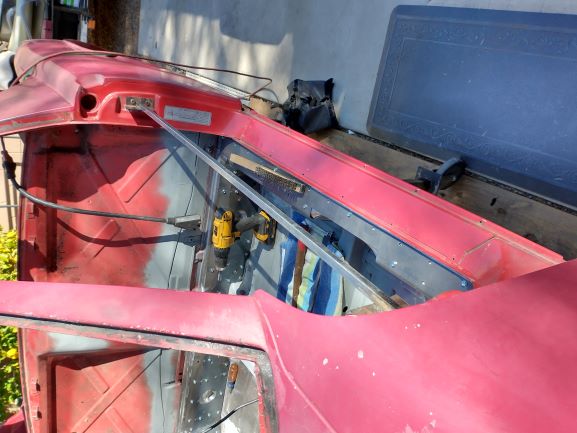

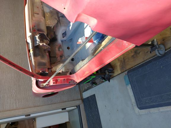

Thanks for the advice/reminder! I ran down to my local Lowes, but all they had was one six foot long 1" square tube - not enough for both sides! They did have some four foot 1/2" square tube. Not super sturdy, but it can't hurt. I checked measurements, and they are spot on - want to keep them that way! Hopefully, these little braces will help. I got them in there nice and snug...
