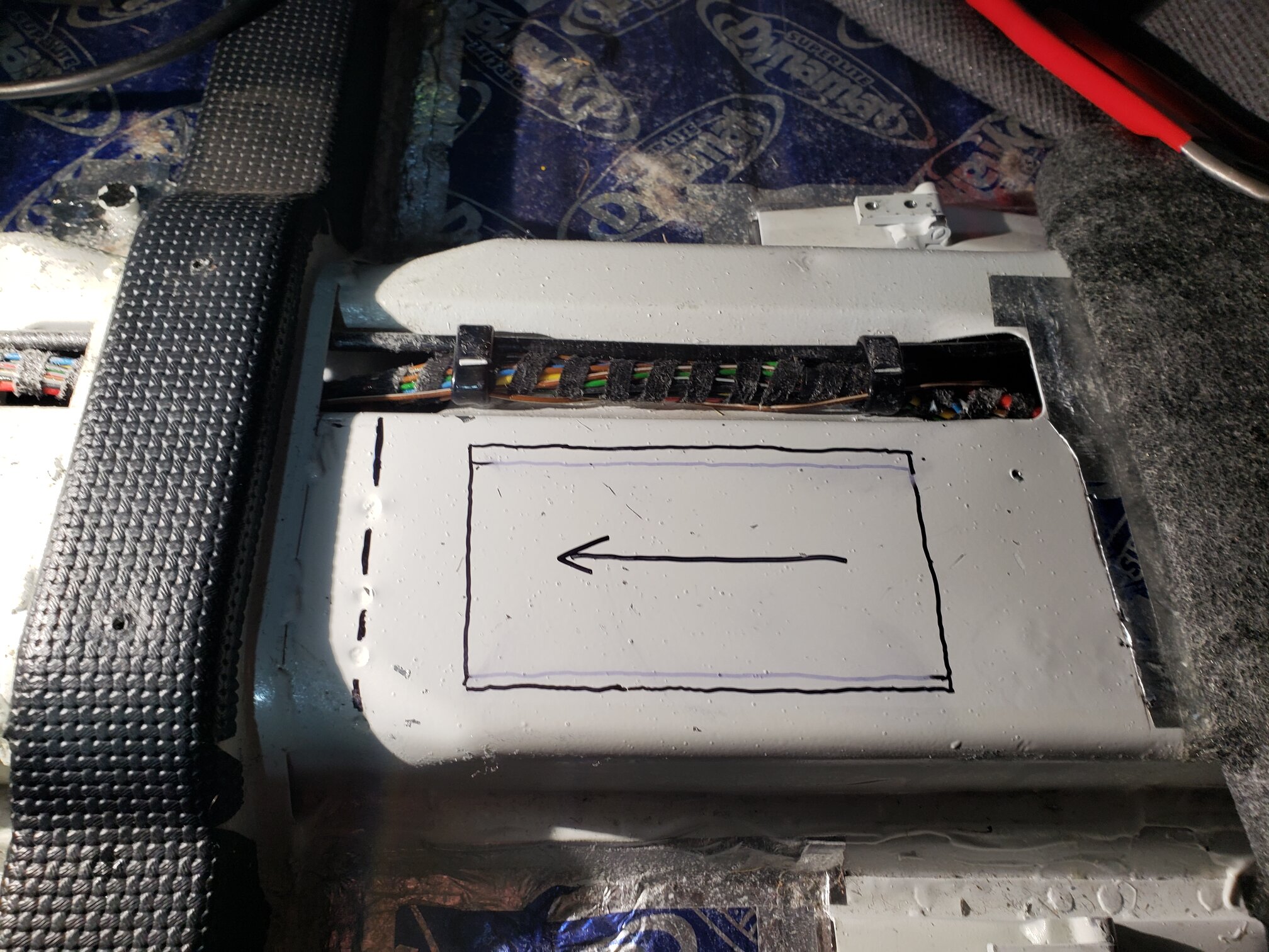

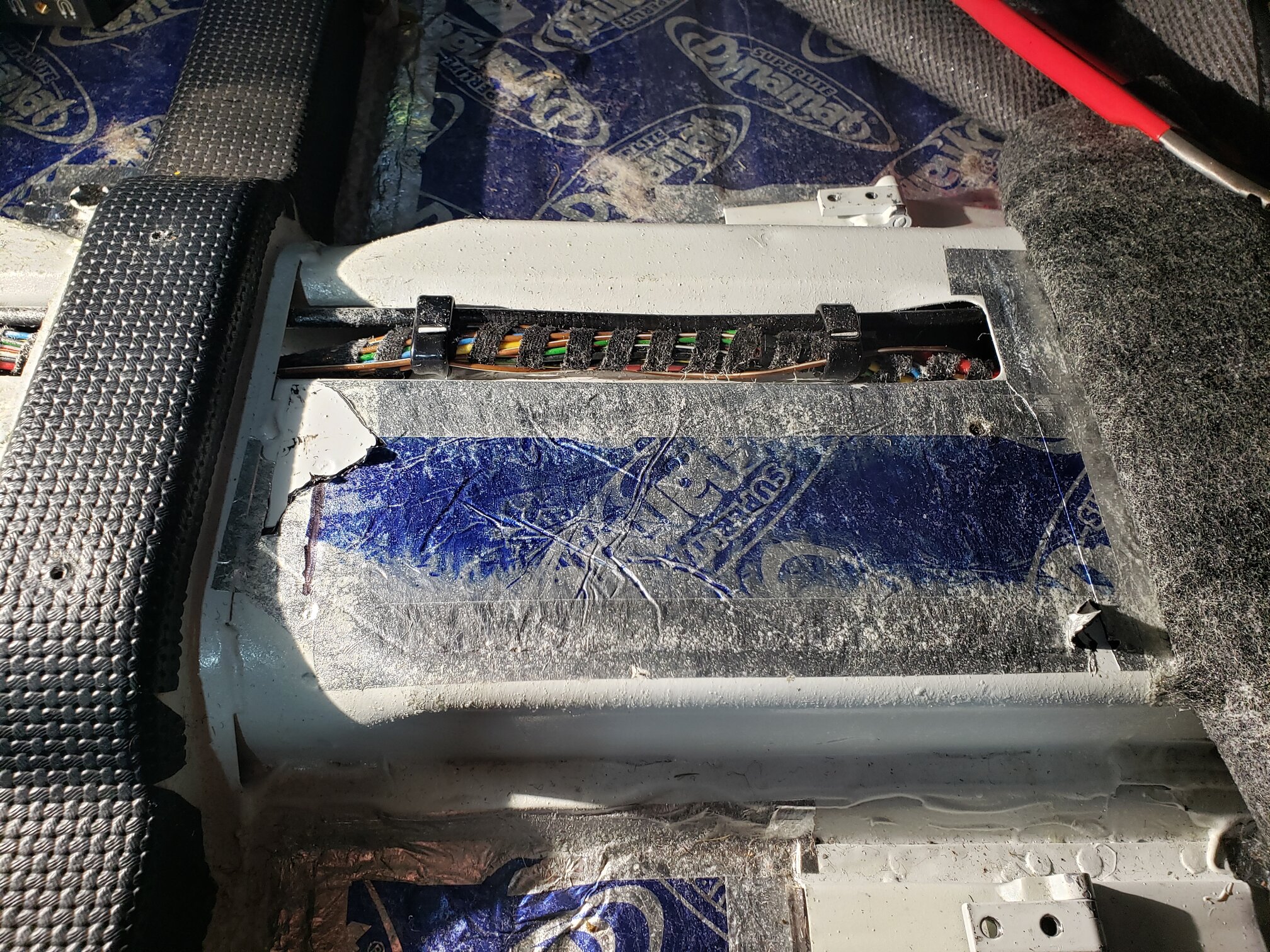

Carpeting pealed back revealing the sound deadening I used.

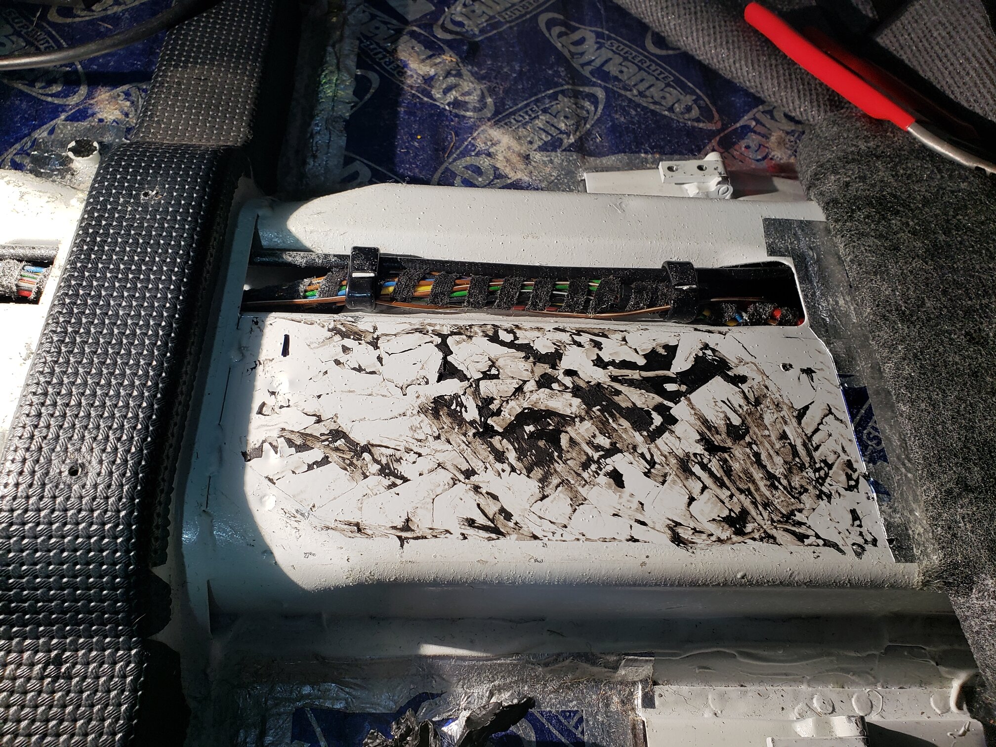

Removed the sound deadening with some of the thick tar stuff left behind.
Had to clean that up so it didn't get all over me, the cutting tools, etc that were coming later.

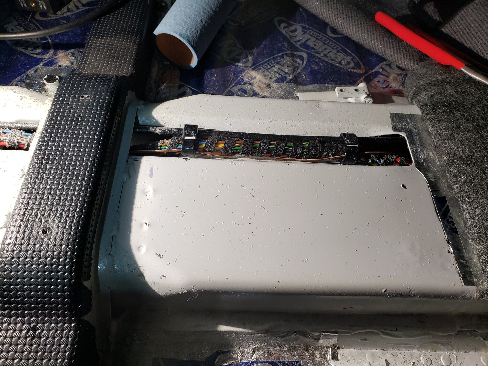

My favorite chemical, 3M Adhesive Remover, made quick work of that mess.
Plotted out where the bulkhead wall/hoop was located and where I was going to cut my access hatch.
Don't surgeons draw on you before they make their cuts??? (IMG:style_emoticons/default/wink.gif)
You can easily see all the spot welds that are used by the factory to keep this bulkhead in place.
