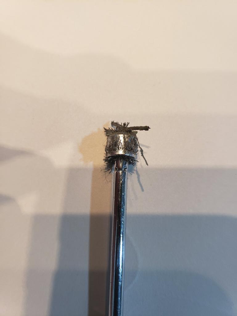

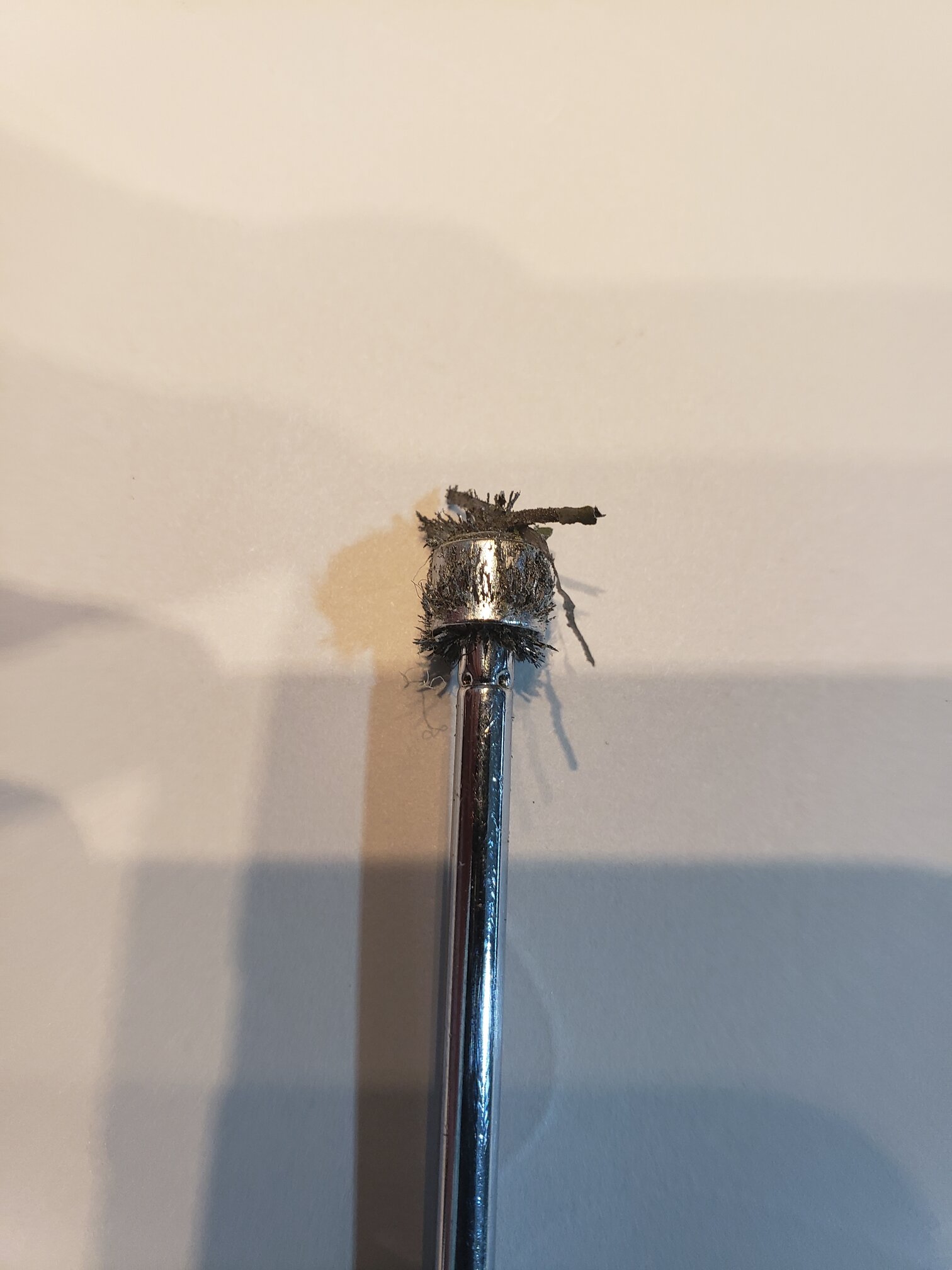

QUOTE(mepstein @ Feb 7 2021, 12:40 PM) *
A magnet might work well to clean up the shavings.
Yes, have been using that as well as a shop vac and small paint brush to move all the chips to the suction.
Comical how much the vacuum misses that the magnet finds.
Must have pulled the magnet out of the tunnel 10 times with this amount of metal filings attached.
Good to get most of that out of there.

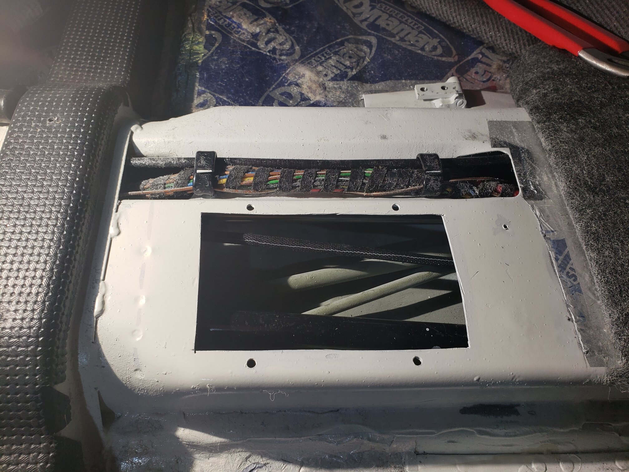

Afterwards I used a small paint brush and applied a couple of coats of etching metal primer to the edge of the hole I enlarged in the bulkhead and also along the edges of the access panel I cut out.
Then went in with some of my "touch up" paint in a spray can and hit the tunnel and the access hatch.
After this all dries, I'll install the access hatch top and begin putting the interior back together.
Nice to get this job behind me.
Have needed to get this done for over a year since picking up my completed project.
Always thought the scraping/squeak was in the shifter itself, but multiple times greasing it never eliminated the noise.
Now the reason is apparent why that never worked.
