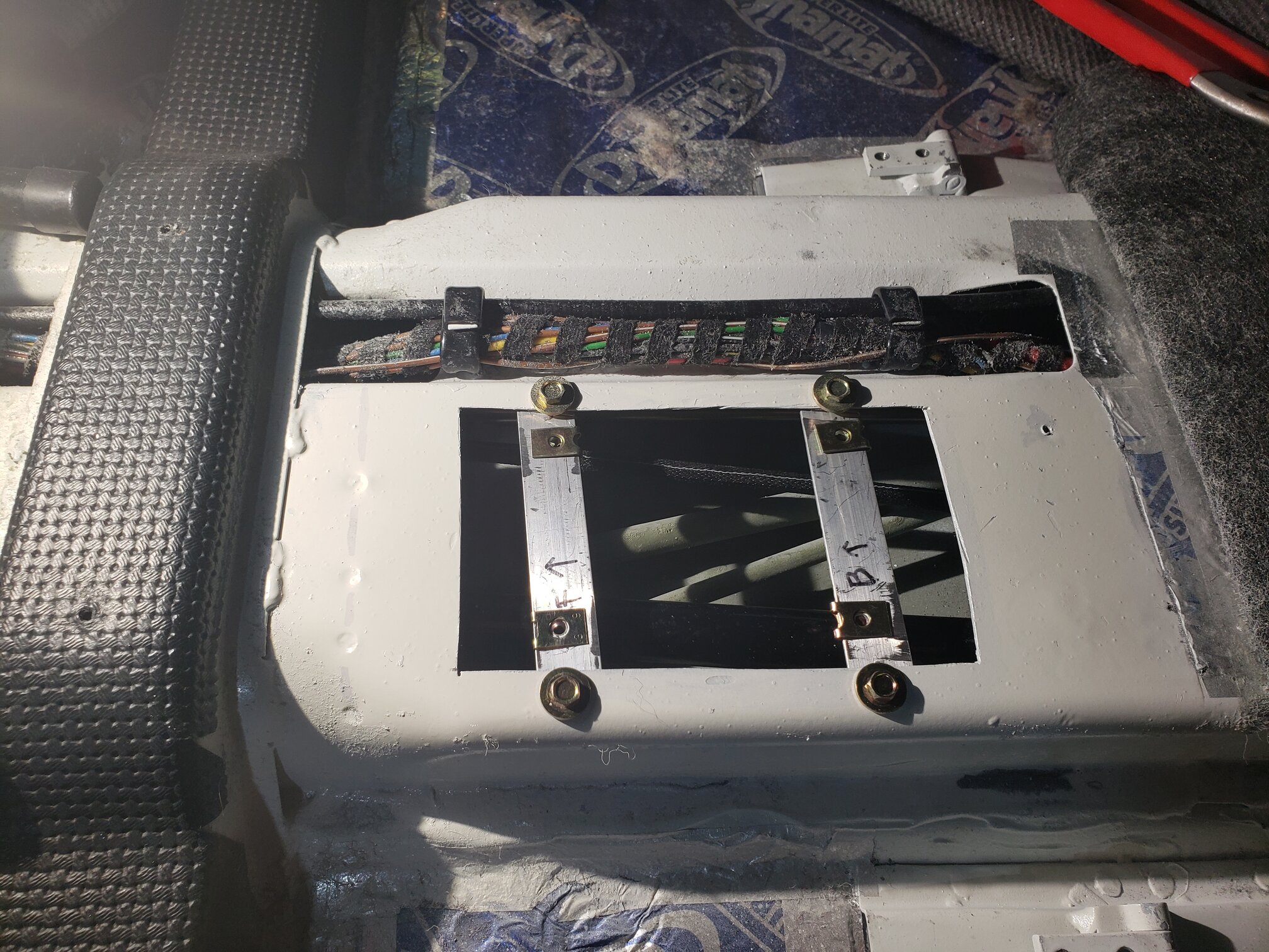

I'll have to admit that this is a pretty crude solution for putting back cover on my access hatch into the tunnel, but I don't have a welder (or know how to weld for that matter) and I wanted something easy to access in the future if necessary.
It was going to be hidden under some carpet and the center cushion.
Plus I wanted to use materials I had on hand.

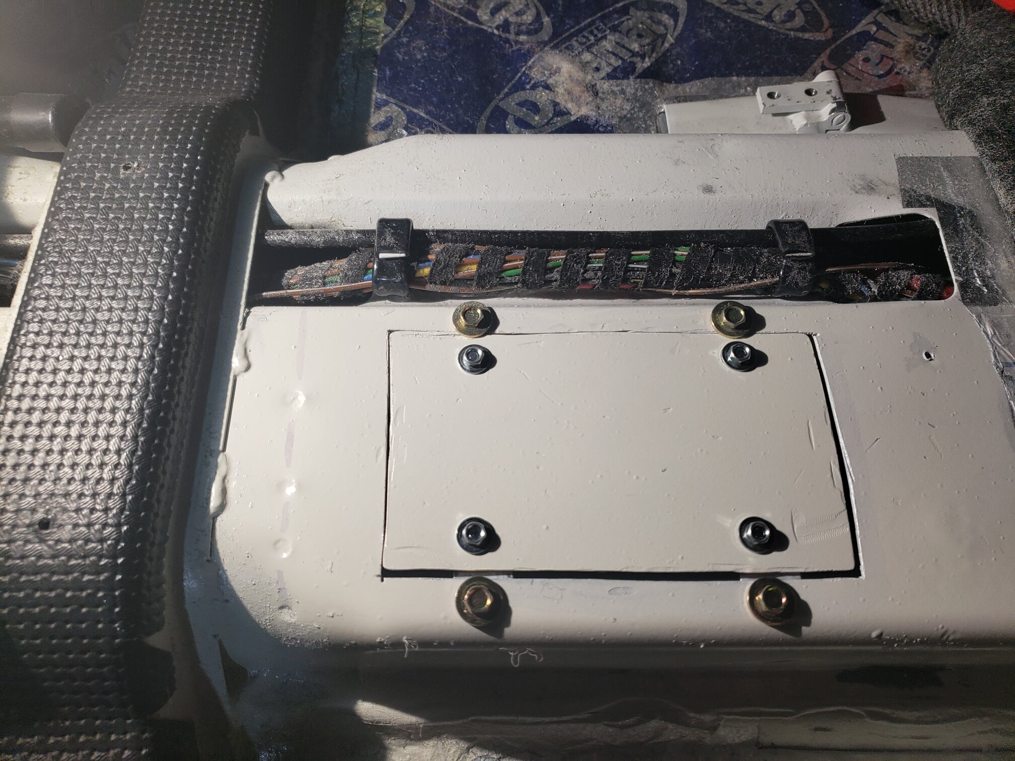

So I installed a couple of aluminum straps for the tunnel lid to sit on.
Speed nuts were used where the hex head screws would be installed.
Each aluminum strap had 4 speed nuts.
Like this:
Then the tunnel lid was screwed into place:

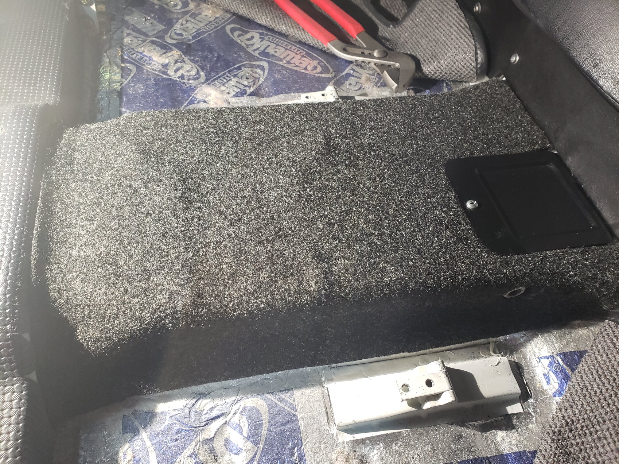

After that came some of my carpeting next:

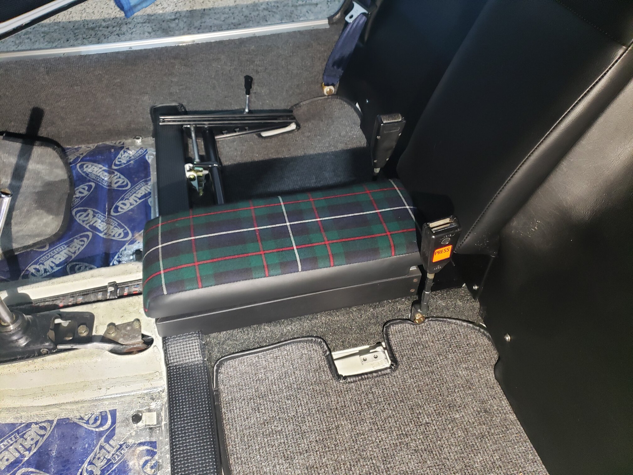

Then finally the center arm rest cushion/depository and the remainder of the interior will follow:
Almost like nobody had even been there......
hehehehe
Again it is so nice to be done with this job and be done with that annoying scraping sound while shifting.
