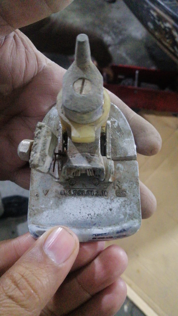

Asheikh   Wondering if this is repairable   Feb 9 2021, 12:05 PM
